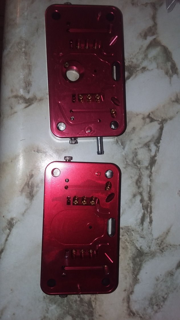

i want more adjustment from screws. Transfer slot is a square on both prim and sec.
Have quick fuel metering blocks 34-105qtf.
Jets are 71 and 83.

metering blocks
IFR- .031 to .033 to .030 to .027
PVCR- .062
Emulsion bleeds- .026
PV 4.5
PRIM and SEC nozzle .031
I cant believe it hasnt leaned out! I've studied and researched this and am pretty darn knowledgeable about this. I modified my body to accept screw in air bleeds also.
if anyone has any ideas let me know please! I was going to try and go even bigger on IAB and .003 smaller on restrictors.

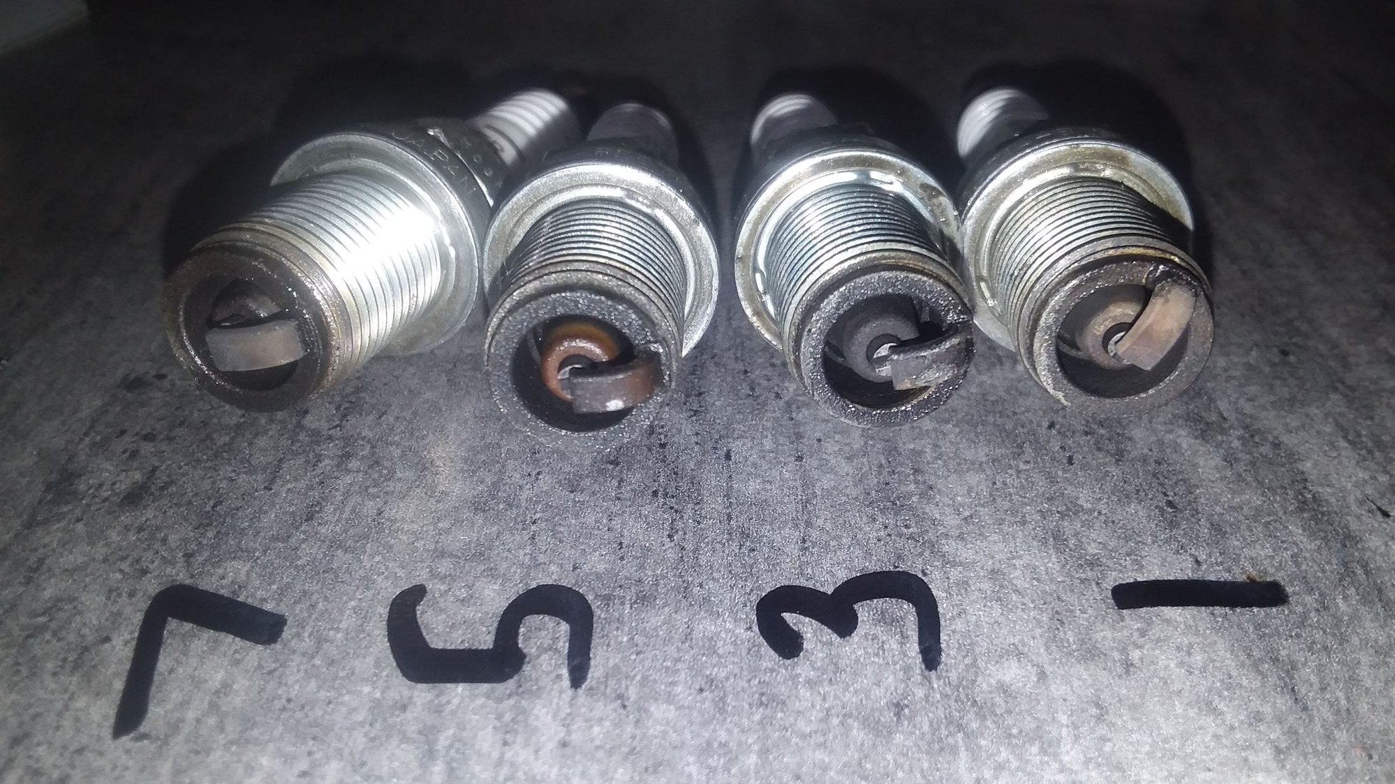

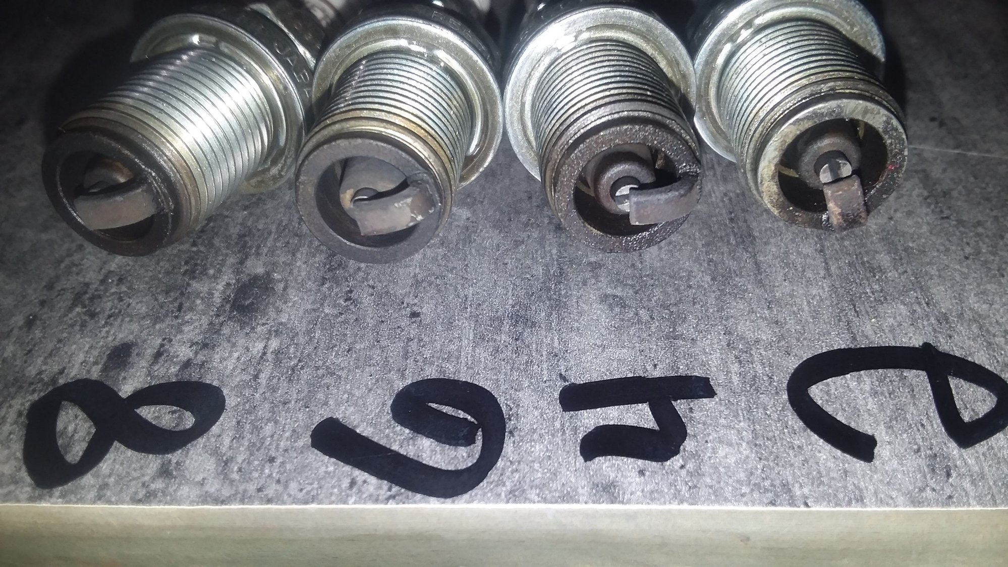

I am almost wondering if my afr is bad but when I look at plugs they are rich.
Thanks!

Those plugs are 98% idle time fyi

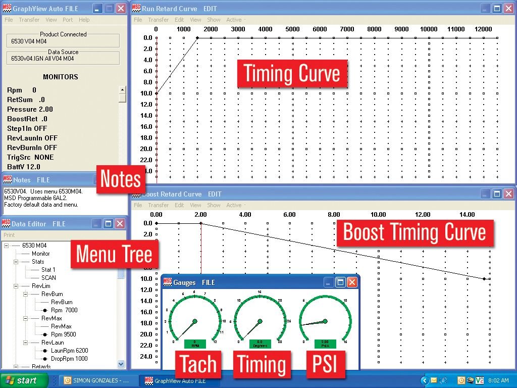

So with this 6al2 programmable box I can run a 1 bar map sensor and have it add timing in relation to vacuum. As of now until I work out these other bugs I just have a flat curve in that graph.
I can program in a base of 32 deg tho, box has a retard feature built in.

Heres an example of the software for my box. It only pulls timing so gotta think backwards when programming.
Ah ok. Hopefully that works out for you. I was able to set mine by using a small vacuum pump on the advance can based on the manifold vacuum, and I would imagine you could rig up something similar to test it on your sensor by pulling it out and plugging the hole.
