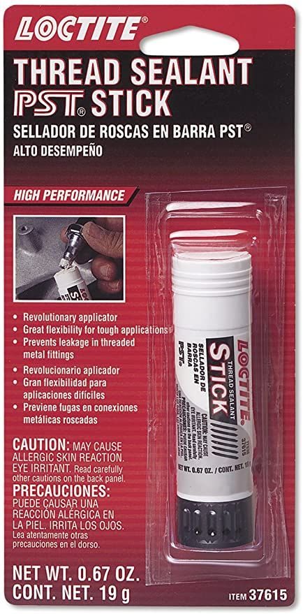

That looks nice. I find it curious that the fittings are NPT rather than flare like the stock fuel line. What creates the seal.
Thread sealant tape isn't really made for fuel applications...

PTFE Paste.
No Tape should be used with Automotive applications...
Too much risk of a piece clogging or restricting a passage (especially Auto-Trans, Carb/ Fuel Systems, Engine Oil Systems, Etc).
