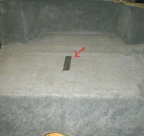

does anyone have some good pictures and measurements of the rear wear pad? mine was missing the rear carpet so I picked up a replacement carpet that is out of a non-convertible so I need to make a replacement and I want it to look as close to the original as I can

The "rub strip" itself looks like a piece of 1/8" Kydex. You can get it here:
https://www.mcmaster.com/thermoplast...thickness~1-8/
The Rub Strip itself is 8" long and 1 9/16" wide.
It "starts" 9 1/4" from the rear seat back, and is centered laterally on the deck.
Jeff
