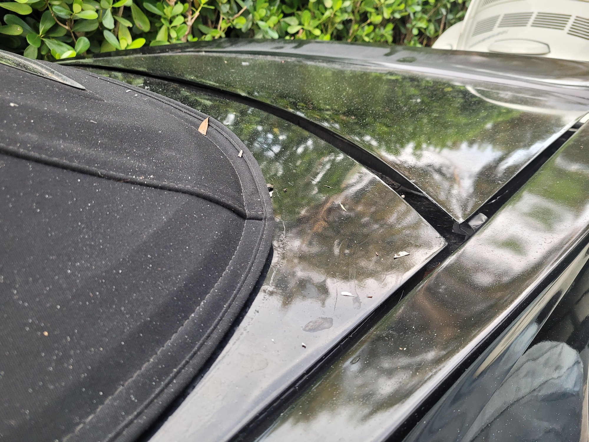

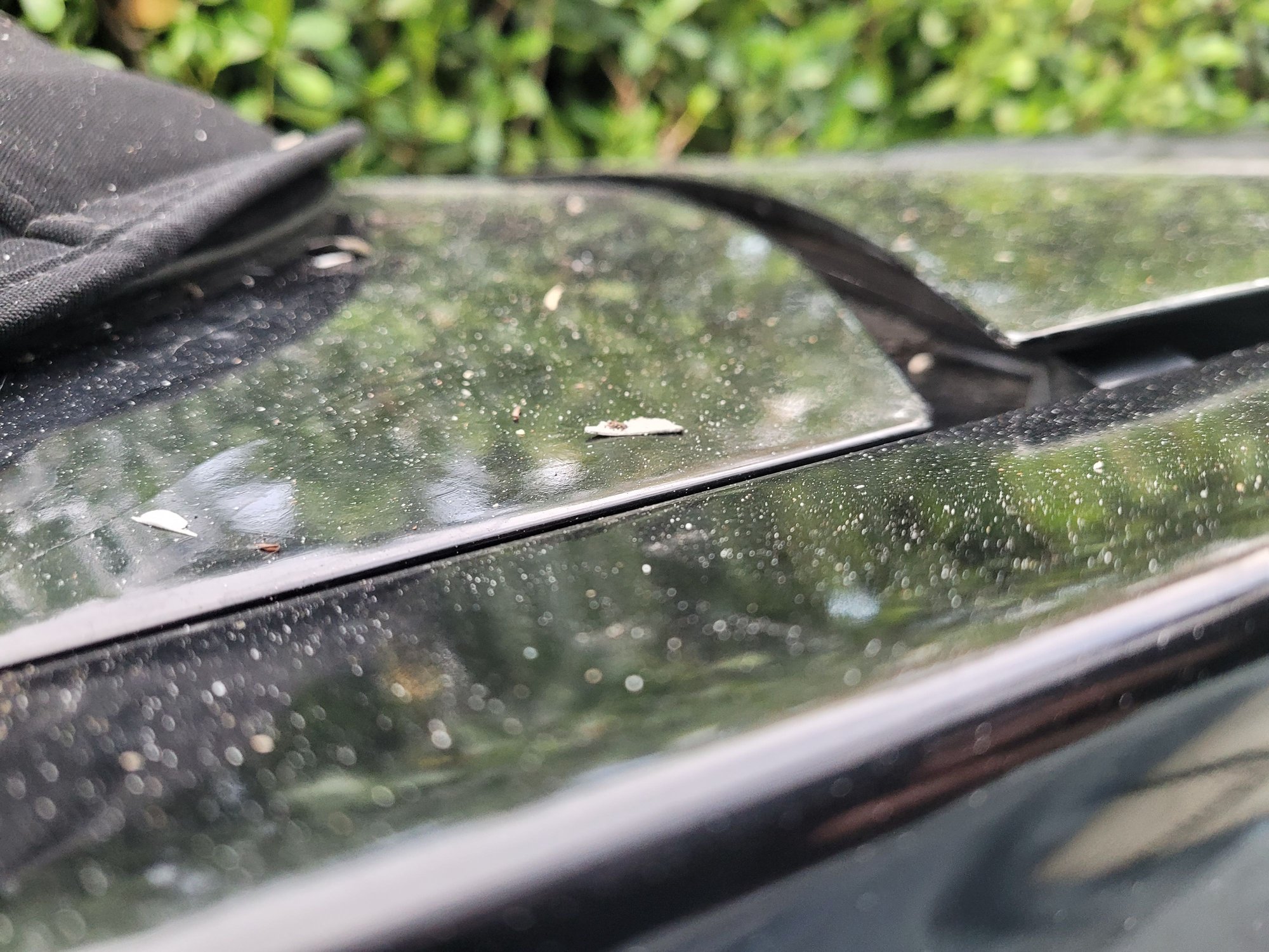

Hello everyone, I am getting the car ready to repaint the rear deck lid and spoiler, my old spoiler broke in to pieces, I can't figure out how to adjust the rear deck lid the front part is way to high (pictures) even if I press down on it it won't go down... is there an adjustment for that?
Thank you!!!

Re: 92 Trans Am Convertible Rear deck lid adjustment
have the same issue, just not as bad.
i think you will have to find where the hinge attaches to the body and adjust it there
THank you Chris, I looked and did not find anything to adjust...
The adjustment is made by repositioning the hinge rods that attach the trunk lid to the body. There are 4 screws (2 on each side) that control the up, down, and side to side motion. They also control the gap between the trunk lid and the rear of the tonneau so be careful when adjusting.
Thank you TAvert91 I am going to take a look at it again.. do I need to open the tonneau cover to access those screws?
No.
No.
They are attached from the trunk hinges.
