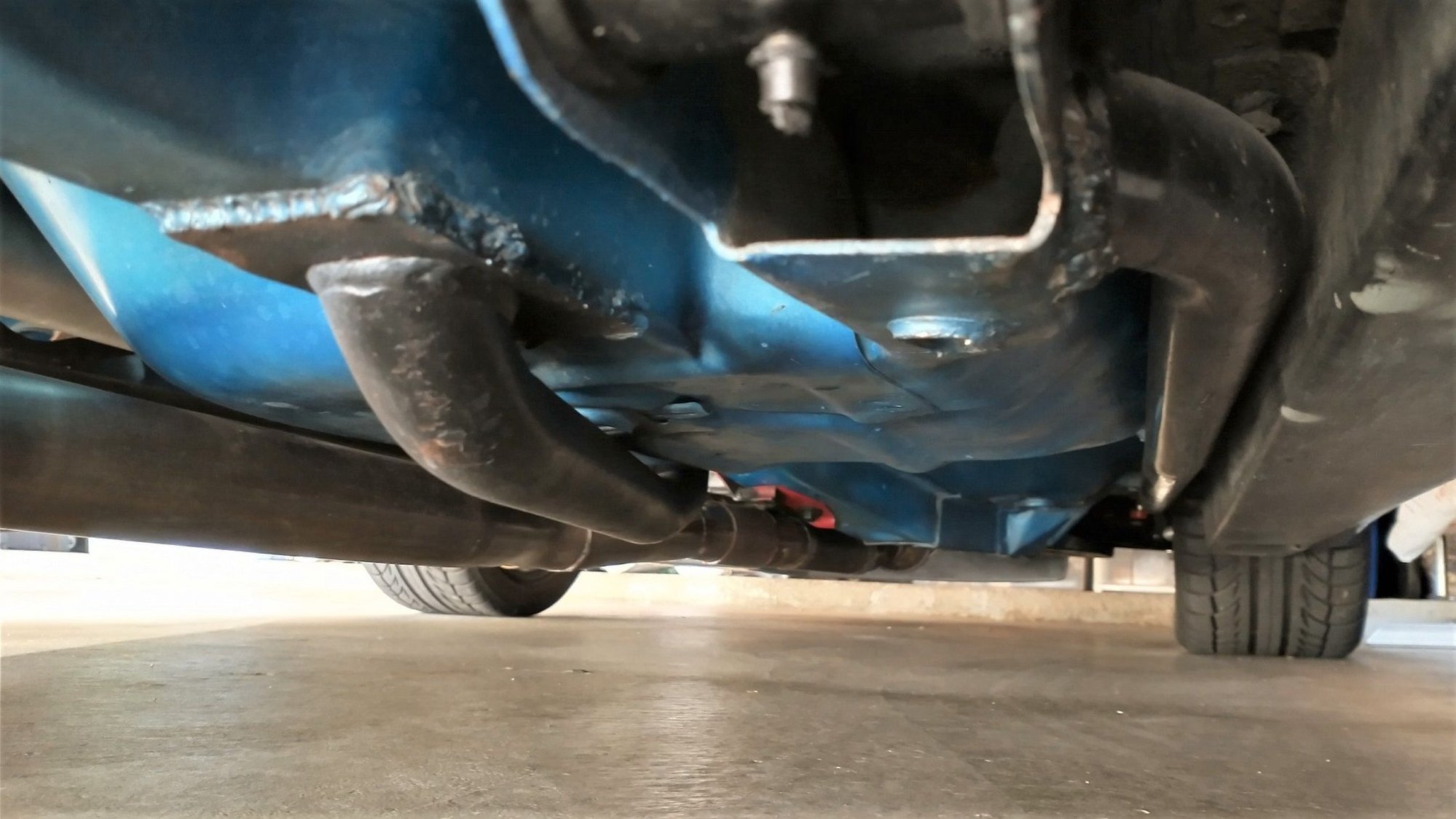

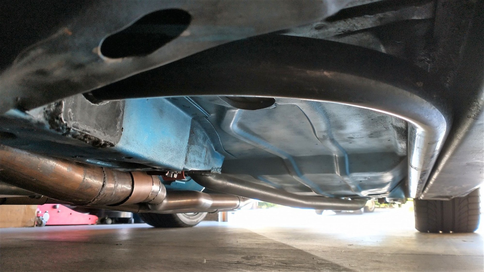

Best fit is a matter of opinion. There's only a few SFC that are made to fit our verts. Lon here (TDS.com) sells the type that fit verts (middle set). The outer ones are from global west, but are for coupes. With a little cutting i got them to fit my car. I prefer them cause they are tubular and match the center SFCs. Which were on there first. Search the forum, there's plenty of pics/opinions/brands to choose from.
Driver.
Pass side

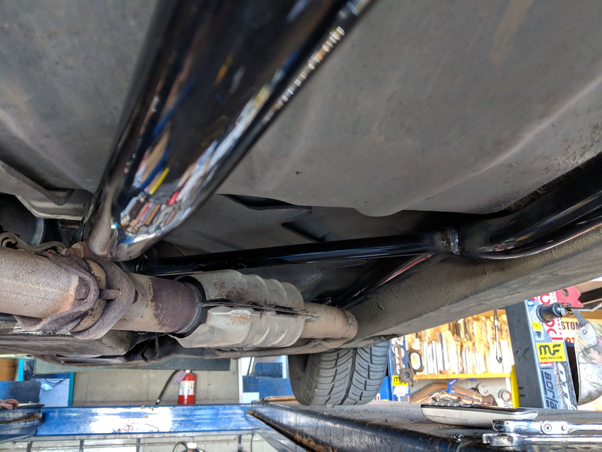

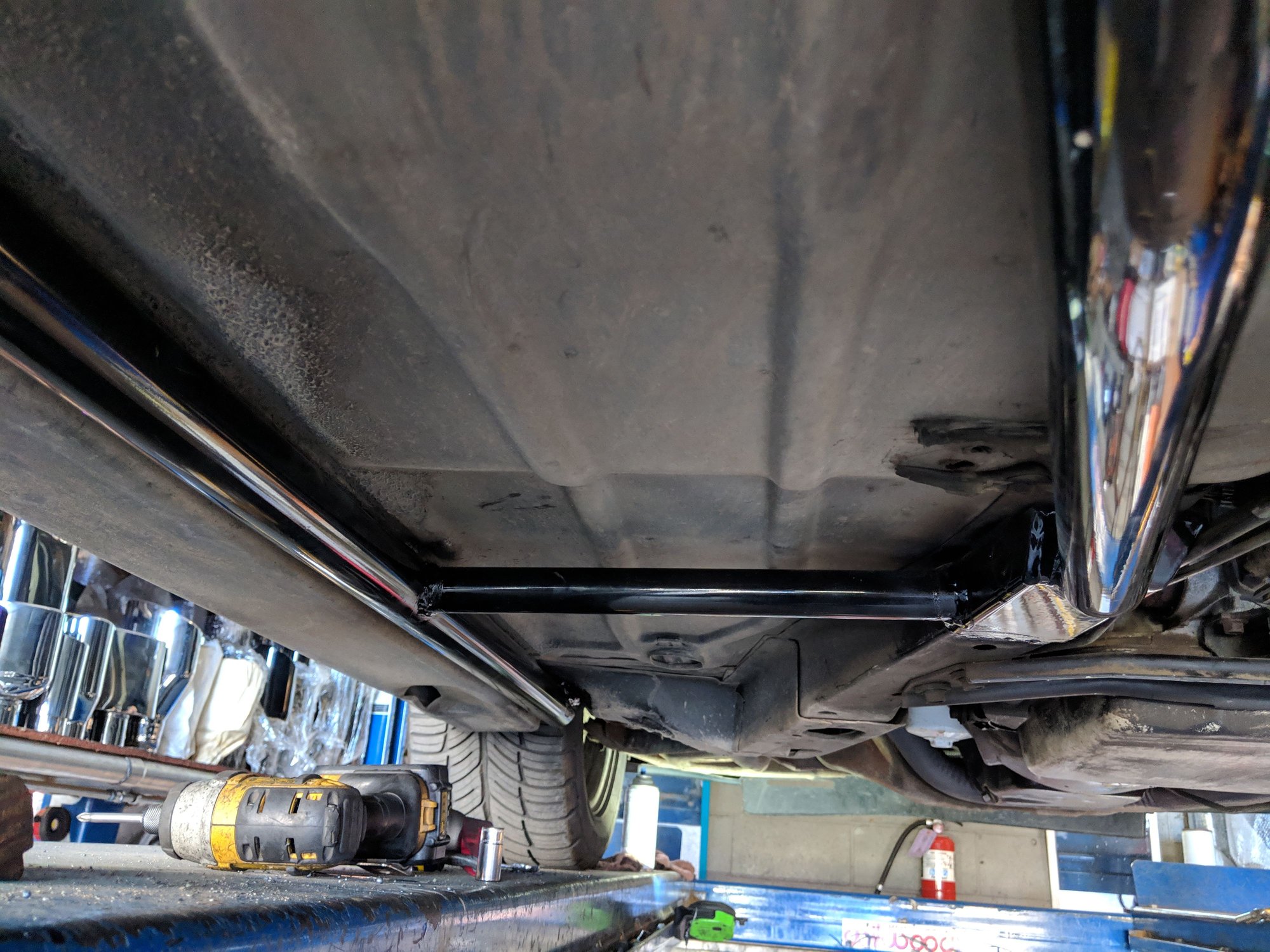

Not sure if they sill make them (you'd have to go look), but Spohn had the outer SFCs specifically for convertibles. I installed them and the inner Alston's on mine.

Those spohn look a bit like my G.W SFC, except mine is straight on the P.sd and D.sd has a bend towards the front. Im guessing that bend does what your crossbar does on the Spohns. Did you add those or did they come with the sfc's?

They came with the parts from Spohn.
