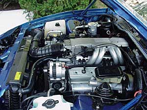

I made my own exhaust covering with fiberglass cloth. I cut it to a size that would fit over the manifold easily to cover the rust on the stock exhaust. I made it several layers thick and put aluminum foil between the layers of cloth to prevent hot air from being able to come straight up. I sealed the edges with a high temp "glue" made for mufflers. I painted them with high temp silver paint. Now they hide my rusty exhaust manifold well. They were easy to slip over the manifold next to the engine. You can just see it in this pic of my engine bay, just below the valve cover ....
