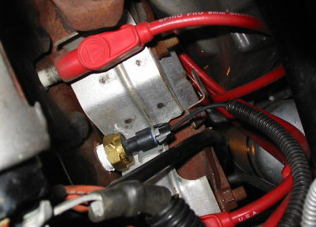

The fan switch needs to be replaced. It's on the passenger side head between the #6 and #8 spark plugs. You can order one from Jeg's or Summit for around $40.

the passengers side works like GKK said, by the fan switch, or the a/c pressure switch, your pressure switch must work since you said the fan comes on. the stock fan switch is setup to like 238 degrees or close to that and that will ground the relay and turn that fan on.
