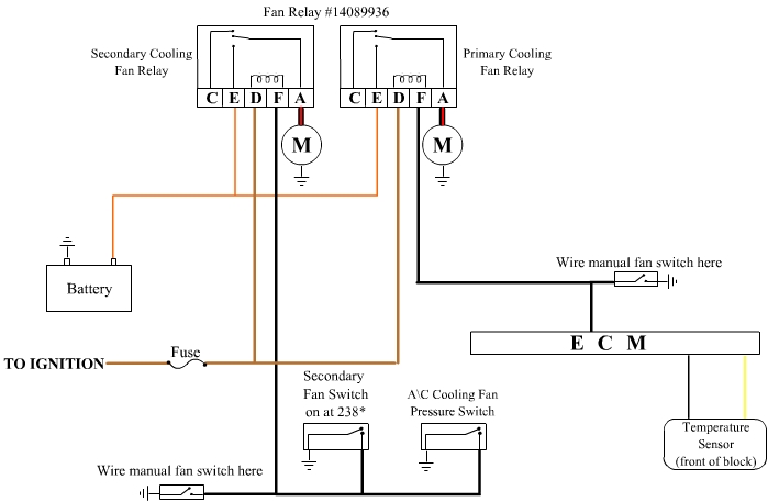

drivers side fan should come on around the high 220's.
so if your car just idles does anything turn on, if so what temp?
drivers side is controlled by the coolant temp sensor on the front of the block / intake manifold.
the passengers is controlled by the fan switch and a/c pressure switch, etc.

Driver's side fan comes on when A/C is turned on. I think it kicked on once when the temp was high. The pass. side never seems to come on. I swapped the relays and they seem fine. I swapped the fan wiring and turned on the A/C and the pass side turned on so the fan itself is good but normally never comes on. ???

Check your fan grounds on the radiator support and check all connections .And also check the fan turn on switch under the car back of oil pan look up on pass side there will be a goldish switch check that and the wire that goes to it .It may be frayed or burned..Good luck
