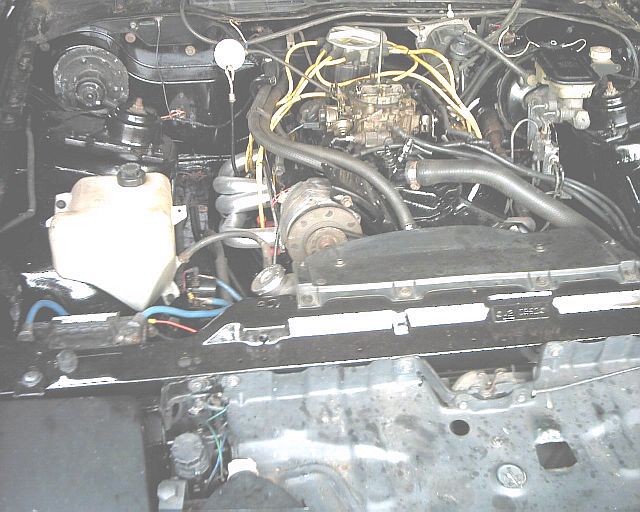

The heater core itself won't care which way the coolant flows through it, but the fittings on it are two different sizes - 5/8" and 3/4". Generally, the 3/4" is the inlet coming from the fitting on the intake manifold. Here's how I have them routed on my Formula
