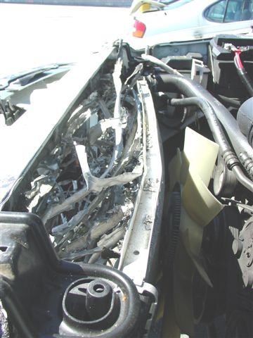

A/C, something to think about
ouch

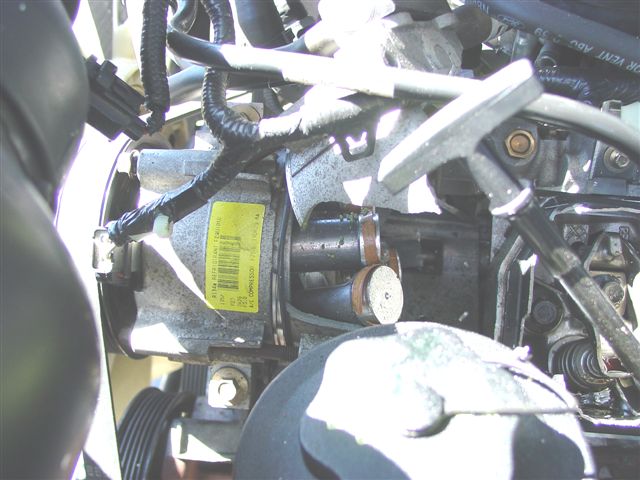

Axle/Gears: 2.42 too high
another 1 of the compressor
Attached Thumbnails A/C, something to think about-compressor.jpg

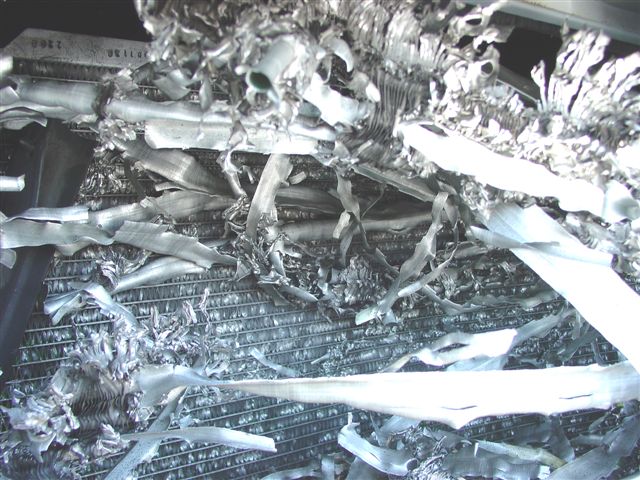

same truck, but the condensor
Attached Thumbnails A/C, something to think about-condensor-top.jpg
Old May 30, 2004 | 06:28 PM
DENN_SHAH's Avatar
Joined: May 2004
Posts: 2,262
From: houston
Car: 83 POS monte carlo 2015 chevy P/U
Engine: 92 5.7 tpi 5.3
Transmission: 700r4 6L60E
the condensor from the frontside
Attached Thumbnails A/C, something to think about-condensor-close-up.jpg

Old May 31, 2004 | 01:11 AM
DENN_SHAH's Avatar
Joined: May 2004
Posts: 2,262
From: houston
it's a ford all right, but they don't know why it did it. some think an over charge and/or for what ever reason over pressure caused it, others think it happened because of the drop in replacements that contain hydrocarbons ignited for some reason.
i could see over pressure taking out the condenser or the compressor, but not both at the same time.
there have been other vehicles that this has happened to, but they just don't say anything about it.

Old May 31, 2004 | 03:58 AM
84 Z-28 350's Avatar
Joined: May 2001
Posts: 702
From: Houston TX
Car: 84 Z-28 Camaro, 2022 2500 silverado
Engine: 383
Axle/Gears: richmond 3.73, eaton posi
I don't see how it happend, my A/C has a pressure relif valve on the back of the compresser it relievs when the system reaches 3000psi (it relieves when I turn the a/c on and forget to turn on my 2 fans in front of my condenser)
Old May 31, 2004 | 08:09 AM
thirdgen88's Avatar
Joined: Apr 2003
Posts: 1,751
From: Bonner Springs, KS
Car: 1995 Corvette
Transmission: 6 spd Manual
Axle/Gears: Dana 44, 3:45:1
Don't really see the alternative refrigerants being a cause unless they were stupid enough to use them (reasoning being that it looks like a factory R134a system?).. Somebody sure fragged it though.
