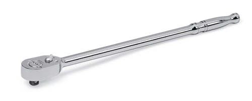

as far as that m-fn top bolt designed by gm engineers without ever talking to mechanics who have to deal with their poor design choices with no consideration for level of effort required to r&r their bs designs goes...
post #96 has a good picture of where your 1/4" drive rachet with a 7mm or 9/32 socket needs to be when you're working upside down trying to remove it.
having just did this in a 1989 Camaro Rs Convertible 305 TBI 700-R4. I'll add that using a extra long 1/4" rachet like one of the two i've posted will make this easier still.
The standard length craftsman 1/4" drive rachet like the one shown is 5" oal and the two snap on extra long 1/4" drive rachets i've posted are 10-1/2" oal.
while you can do it with the 5 incher the end of the rachet is near the bottom of dash making it a difficult two finger operation for me.
on my 89 rs removing dashpad, speaker or loosining the dash was not needed.
pulling the ecm out gave me plenty of room.
I did pull my dashpad and speaker off to see if ir would be any easier that way for r&r and for me it was not.
the best way for me was with passenger seat removed so it was more comfortable to work upside down, i found the braile method the best way to get the socket on that stinkin basturd top bolt, i felt for the bolt with my left fingertips, used my right hand to get socket, extension and rachet close to my left fingers on the bolt head and got it on the bolt that way. Taping the nut to the socket is probably the best way for reinstall.

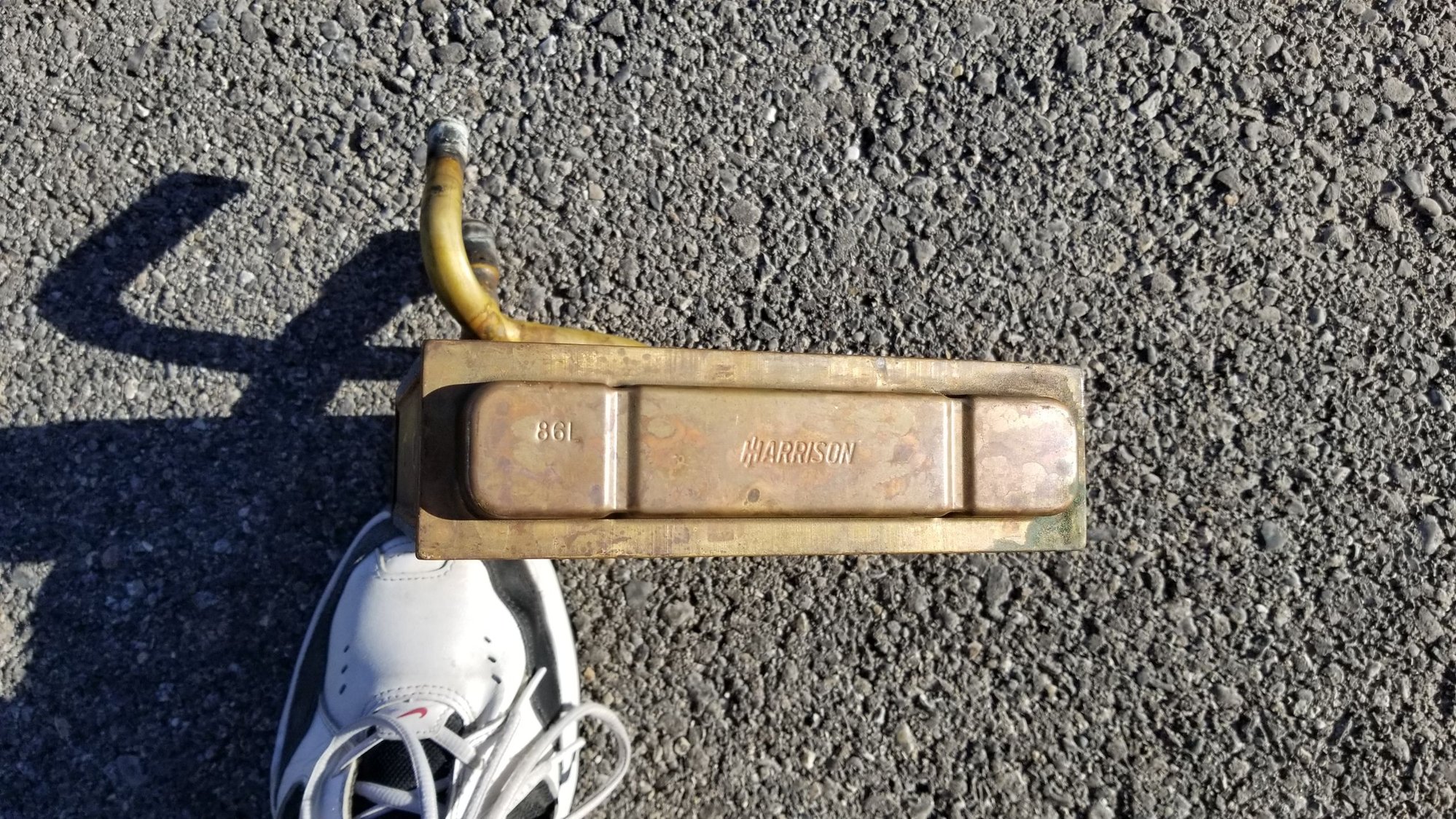

Bypassed my heater core and AC in 2001. But with my interior currently out of the car, if I was ever going to replace it, the timing would never be better.
It came out without much work. But $220-$250 to re-core it? I expected $100-$150. But after talking to a couple of shops, apparently that's a realistic price range to re-core our type of heater core. Here's mine after removing it:
After reading about so many people's bad experiences with replacements, I went on a quest to find something better than those. So I searched some known part numbers:
98606: FVP(linked by Chazman) and Pro Source(available at Auto Zone). PS is probably FVP's product, which appears to be a distributor or manufacturer, not a vendor.
94606: Murray and Spectra Premium. Murray looks exactly like the Spectra Premium, FVP and Pro Source, too, so whoever makes one, probably makes them all.
399083: Spectra Premium comes up here too, along with some store brands.
A local store had a Murray core on hand, so I took mine and compared them. The Murray, by the way, IS a Spectra Premium, and it will "fit," sort of. It's smaller than OE and leaves gaps between it and the frame, but its tubes looked to be aligned correctly, so it can be made to work. But it's so CHEAP, just like all of the others.
Our OE core(just the core) is 7" x 7" x 2" thick, and these replacements are 6-3/4" wide x 5-3/4" tall x 1-1/4" thick, with 1/2" tall x 2" wide frames across the top and bottom to make it 6-3/4" square, then has foam across the top and bottom to try to fill the gaps and make it "match" ours. Really? That's the best anyone could do? And some genius in a corporate office approved it. LOL! WTF?! Light as a feather, too, like made of aluminum foil. I probably could've done a pretty good 'Matt Hooper'(from "Jaws"), and crushed it with one hand. Disappointing that this junk is all we have to choose from.
But also coming up with part number 399083 was this interesting find, exactly like our OE core, exact dimensions too:
https://www.northernradiator.com/Product/399083
So I called. Northern Radiator is a nationwide distributor, so Nolan contacted all of their warehouses across the country and then called me back a few hours later. None in stock anywhere, sadly. He told me the manufacturer is Thermal Solutions in the Chicago area and gave me the phone number.
A search for Thermal Solutions showed it to be a very popular name for businesses of this nature, but I did find one in the Chicago area that manufactures heater cores. Its product's brand name appears to be Ready-Aire, which I think was also sold as Vista-Pro, and is probably the same "Ready-Rad" product Bohemian mentioned in the post above mine. The website mentions 11,500 applications for heater cores!
https://www.thermalsolutionsmfg.com/heater-cores/
But our model isn't listed. 11,500 applications, yet ours appears to be no longer available. And with Northern Radiator confirming that none of its warehouses had any stock, it looks like we'll have to go directly to Thermal Solutions and beg. I didn't phone TS today, but I will tomorrow(which will be today by the time I post this).
Maybe WE can convince TS to produce them again. But they're not likely to be cheap, like the tin foil replacements. And we all know how "group buys" go around here LOL, so I hope that isn't what it will take to get them made. But if they're reasonably priced, whatever that is, then we should, at least, be able to make it worthwhile for TS to have produced these again. Seems like our best, maybe only, chance to get a good, OE-like heater core again. Probably now, or never.
If these hopefuls don't pan out, and they didn't, as you'll read in my next post, two below this one, then re-core it will be. Not for "originality," because, frankly, 95% of these cars are and will forever be worthless, mine included, and originality isn't going to save them. But in this case, only OE fits correctly, no others do.

I just talked to Thermal Solutions, Tina. She was very nice and as helpful as she could be. Their heater cores WERE exactly like our originals. They just recently discontinued them, scrapping all of the leftovers, so none exist, as far as they know, and they don't plan to produce more in the future. I asked, "what if I can get a few hundred people to start calling you?" Got a laugh, but no, no plans to start producing them again. So if anyone happens upon an OE-style heater core, I'd suggest you grab it, whatever its price. It's not likely to be a "$33" product like the typical replacements, but it will be far less than a re-core, which she confirmed is far more expensive than buying a manufactured heater core. So $250 is not unrealistic, if it's an OE-quality core. So re-core or replace comes down to each person's priorities.
