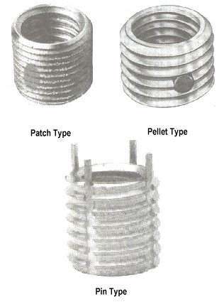

If the hole you drilled is still in the correct location, and hasn't tailed off to one side, you should be able to install a thread insert and new bolt. If your drilled hole is already over 5/16", there is no tapping the hole for a new 3/8-16 bolt.
you may need to tap 5/8-11 and install one of these:

Where can I find those inserts? They seem like a plan.

You should be able to find them at any parts store. Any place that sell Heli-Coil stuff will have them.
