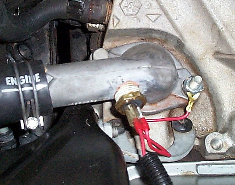

There is no "hidden" bolt of which I am aware. There are only two, and are in relatively plain sight:
The throttle body might be in the way of a deep socket and long extension, but a regular box wrench or socket/ratchet should do it for the rear one. The front one may require the wrench only.
