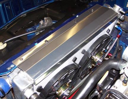

Re: Why Are There No Direct Fit Radiators
Took care of the finishing touches today.
Old Feb 18, 2008 | 12:45 AM
  #61
luke4907's Avatar
Joined: Jan 2004
Posts: 431
From: WPB, FL
Car: '89 Trans Am GTA
Engine: TPI350
Axle/Gears: BW 3.27s
That looks great but I'd think that some of the air would just escape over the top of the radiator (and around the sides) instead of going through it. It all looks great, and if it works great too then that's even better. I just wanted to make the suggestion. How did you mount the MAF sensor and air filter setup? Once again, great setup. wish my car looked like that under my hood...
Old Feb 18, 2008 | 01:01 AM
  #62
BretD 88GTA's Avatar
Posts: 2,842
From: Woodland Hills, CA USA
Car: Yes...
Engine: Last time I checked...
Transmission: See "Engine"...
Took the car for a test drive and it's running a little cooler than it did with the stock radiator. So far, all looks good.
To secure the intake tube I piked up a Spectre intake bracket kit for $11 at Pep Boys.

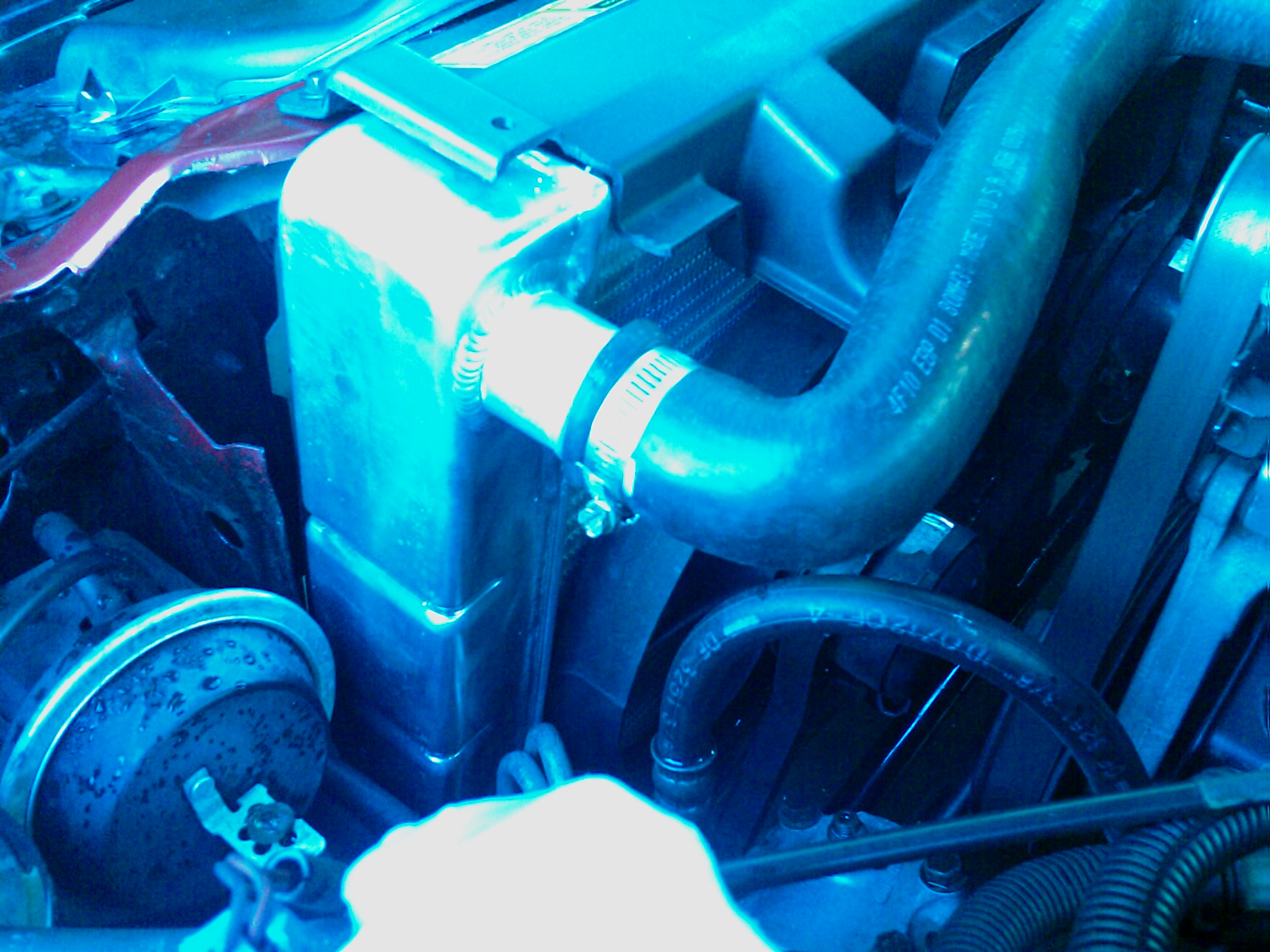

I'm using a Summit direct fit aluminum radiator along with SPAL dual 11" electric fans.
It's pretty tight in there at the bottom of the radiator on the drivers side, but I got it in ok.
I'm using a Jegs direct fit..... It is taller then the OEM Rad. but there isn't much left on my car that is OEM anyway. I made a Upper Rad mount out of some .90 Alum.
Ray

I see some silicone couplers hiding in front of that rad. Are you turbo???? Btw, that upper rad mount looks great!
Turbonetics T76 BB (ordered) upgrading from a t70. Gonna Spray a 75 shot No2, to help spool out of the hole. I'm also running a 3200 Stall.... How do you like your stall speed ?
Ray
Ray
YUM YUM...maybe one day Ill have something like this.
"I H8 WWD" Are you referring to the Upper Rad mount? Very easy to make, and cheap.
Ray
Been doing alot of searches and was really wanting a Summit direct-fit.
After reading the complaints, I decided against it.
Got a new Visteon radiator and it looked great.
Was VERY disapointed to find that the core was 1/4" thinner than the original.
This is totally unacceptable since these cars have age on them and the cooling systems are not the best for heavy summer traffic.
Returned the Visteon and took my chance with the Summit since it looked like replacement radiators would not be any better.
The Summit radiator is made very nice.
There are a few mods that need to be done that are not that bad.
Was not too happy with the upper hose inlet being so long.
I am thinking of cutting it down, but I am not sure if the hose is big enough to go on it.
Had to use an adaptor for the heater hose since the one on the radiator was smaller than the hose.
Had to cut a clearance in the lower mount for the drain.
Modified the upper mount by cuttin off a small section of the end.
Used a couple of washers to space back the fans.
Removed the lower rubber mounts and used cut pieces of rubber to cushion the radiator.
Overall, I am pleased with the Summit.
Bet it will keep these cars alot cooler than the originals or replacements.
Only a little effort and thought went into this installation.
I think many that are not happy with the Summit interprets "direct-fit" as it will install itself and fill with antifreeze on its own....!!
