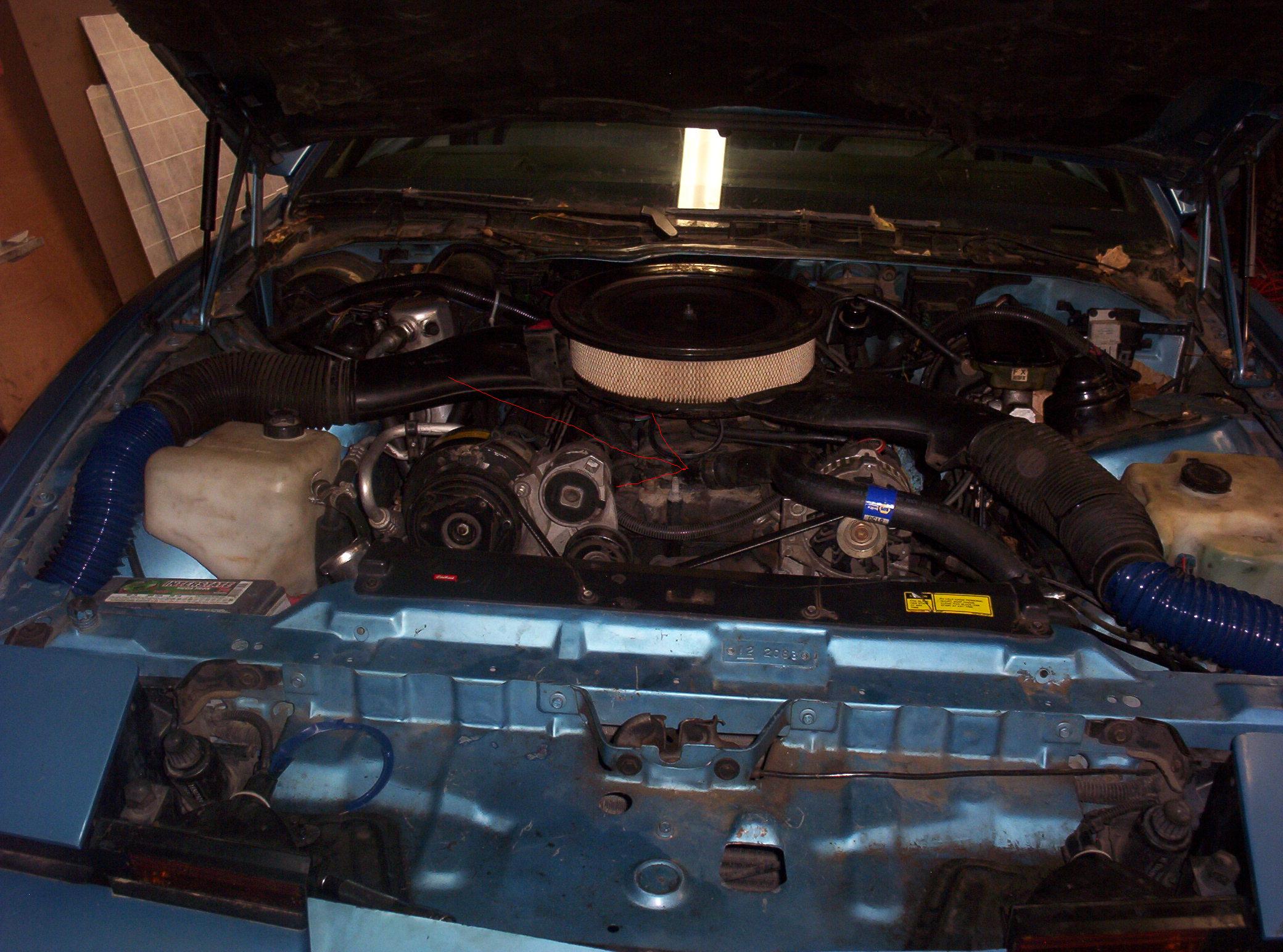

Follow the top rad. hose to the top of the engine. Under that housing is your Thermosat. My engine is easier to see it though. Which engine do you have?

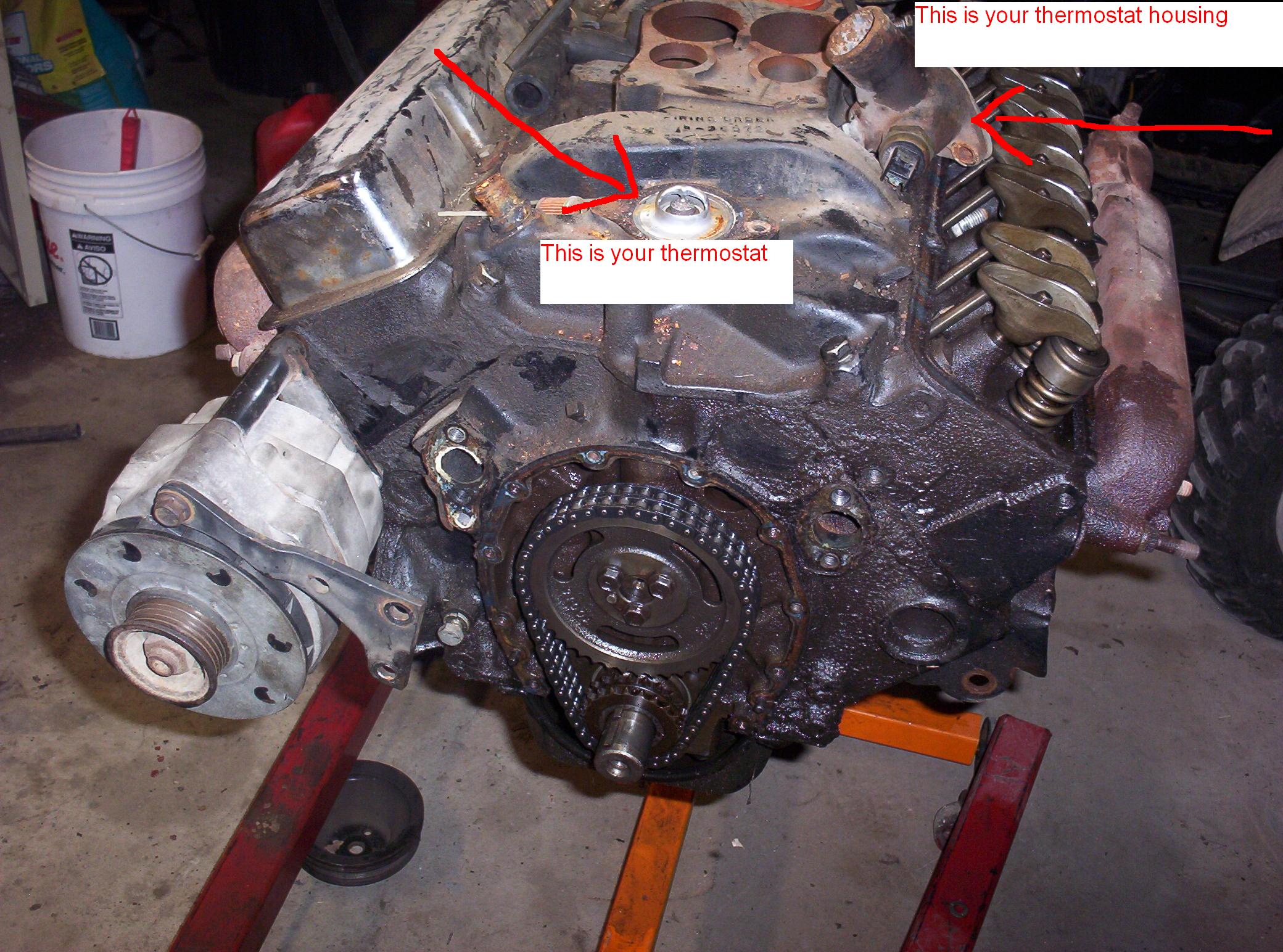

need help :(-thermo2.jpg
The engine in the pic should be the same as yours, which is an LG4. I have the thermostat housing already off in this picture. Get a haynes or chiltons manual and follow the directions in the book. Or do a search on this site. Someone may have already given detailed instructions.

Is it overheating at highway speeds or stop and go traffic, driving around town, or both. If its doing at highway speeds I doubt the fan is the problem. The outside air will keep it cool when moving at higher speeds. But in city/town driving theres not much air movement and then the engine gets hotter and the fans kick on. Try this, start the engine and turn the AC on. Assuming you have an electric fan, it should come on. That will tell you if the fan is good but not the switch.
Something else I just thought of. How cold is it where your at, and do you have the right mixture of coolant?

Re: need help :(
well i live mostly in a urban area so i dont see too much highway travel. yea it is really cold here. 26 to be exact

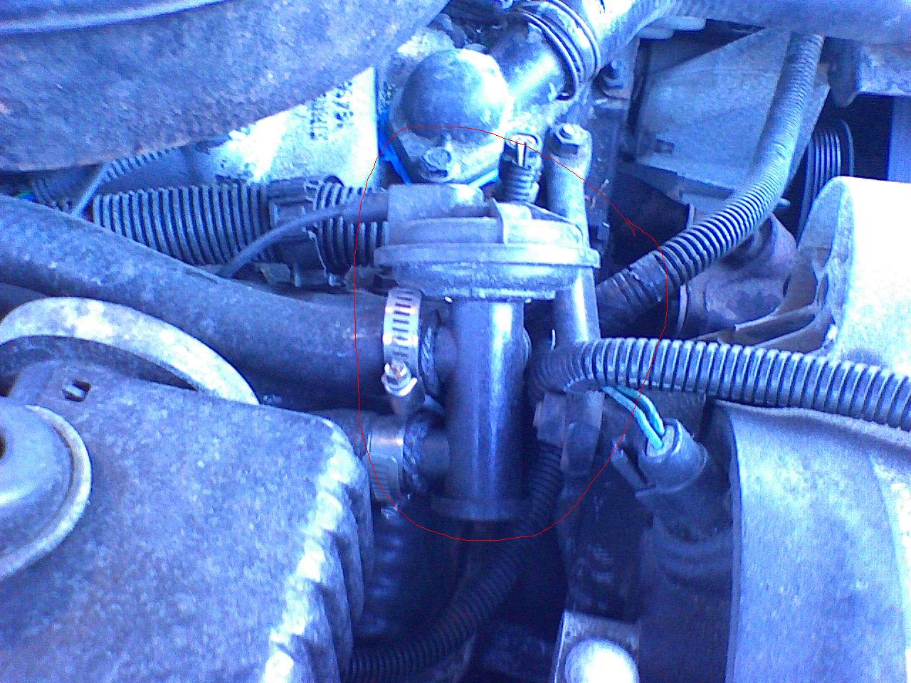

alright check this out. this morning i was planing to take my car up to the shop so they could find out what was going on. so on the way out i decided to take one last peak under the hood.i opened the hood and started the engine. almost right away i see steam coming up from my engine. this shocked me because i always thought the steam was coming from coolant overflow tank but it was actually rising up from the engine itself. so i looked closer, there was green fluid all around my left engine head. COOLANT! so i traced the line to a weird looking device. pic is called "download". so i switched that for cheap but in the process a long skinny cord running to the top of that device broke. u can see where it goes in on pic called "download2". all in all i thought the problem was fix but its not. she still overheats.
Attached Thumbnails need help :(-download.jpg   need help :(-download2.jpg

Re: need help :(
Heater diverter valve is bad. It prevents hot water from cycling through the heater core when the A/C is on. You can replace it with a new one from AZ for around $30, or take it out altogether with either a plastic hose splice or a new heater hose (long enough to replace both pieces) for less than $10. If you don't install a replacement valve you may lose a little AC efficiency but you probably won't notice the diff.
The vacuum line attached to the top of the valve should come from the firewall area. It needs to be reconnected or capped (if you don't replace the valve) to prevent a vacuum leak.
And it could have been that your rad cap was bad and that not enough pressure was building up in the system before you replaced it to notice the diverter valve leak. Long shot maybe.

Re: need help :(
thanks guys for all the help. ill def get that vacuum line replaced soon. i finally just took her up to the shop and its her water pump and radiator that bad. doesn't surprise me too much i guess. the owner before me left my car sitting in a ditch for 6 months without touching it so things gotta be replaced. the shop wanted 600 dollars to replace the stuff but luckily i have a friend that works at advanced auto parts. 150 dollars is all i need to get the stuff fixed. doing Saturday, so i hope to back on the road with u guys soon. thanks agian for everyones help. i appreciate it a lot

Re: need help :(
thats good u found out what happened. I posted earlier. i thought it was the water pump the way u were describing it grateful it is now fixed.
