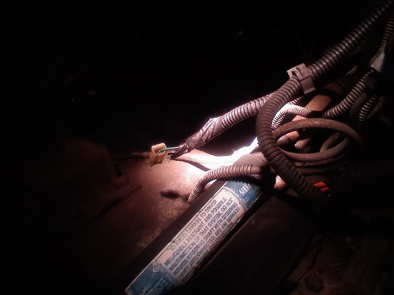

Old Feb 2, 2009 | 11:05 AM
Toyota h8r's Avatar
Joined: Dec 2006
Posts: 584
From: toledo
Car: 1987 Z28
Engine: LG4
Re: Temp Sensor
look for this connector near the steering shaft...its a green wire btw
