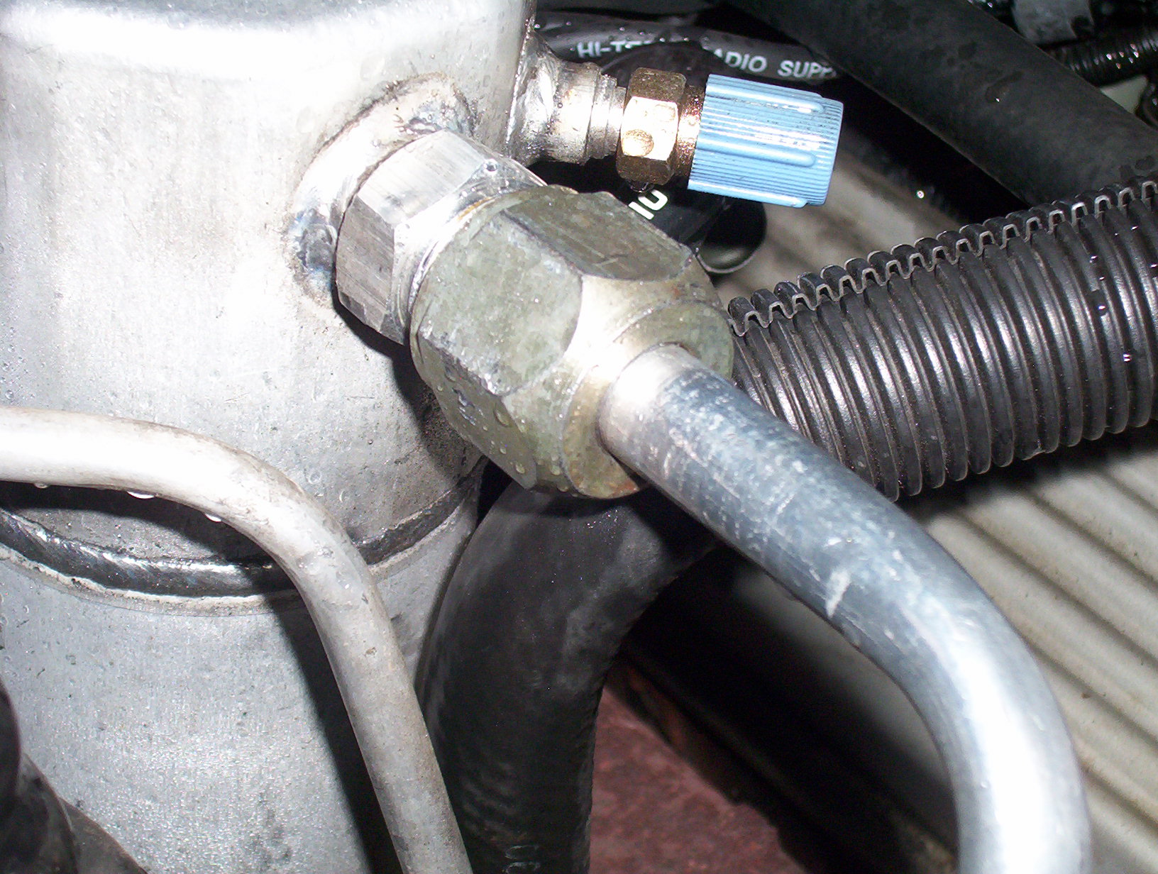

Today i tryed getting the ac running in my car, because i new it worked, it just leaks freon like crazy. Today i tryed getting 2 cans of stop leak and 2 cans of freon, and it the compressor was turning and everything and it started getting freezing inside the car, while all at the same time, it was just pooring leaking freon and stop leak like crazy. i have a picture and the gasket o ring set. But does anyone know how to get the bolt off. i tryed hard with 2 different wrenches but that thing is on there good.

Frequently these are hopelessly seized.
It will be faster test all the nuts, find out which are seized, pick up replacement parts, cut the bad parts out, and bolt in new parts.

Hold the welded end of the accumulator with a wrench, and turn the nut counter clockwise (the low pressure line nut). If your nut is seized, might be wise to buy new lines and an accumulator. Do it when the lines are warm, it might be easier. You might also try to persuade it by putting a pipe on the end of your wrench for more leverage.

And make sure your using the proper tools. You need a line wrench to avoid rounding it, not a regular wrench.
