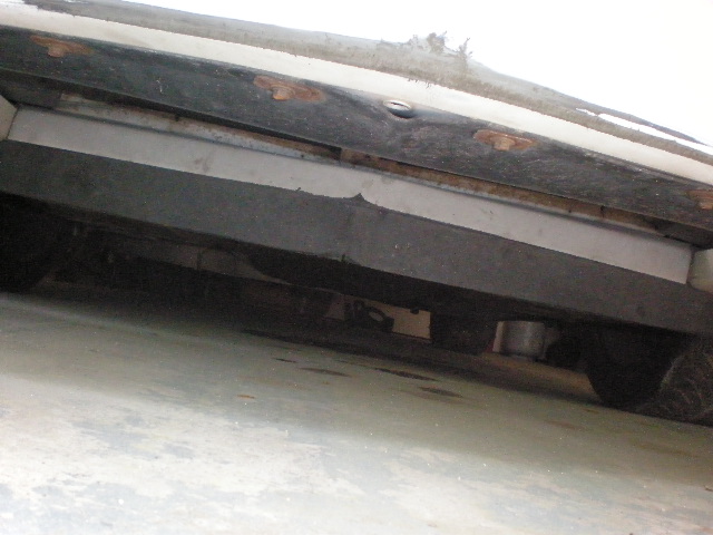

Re: >>MISSING: air dam 2 rad??<<
Pics of my GTA.
Attached Thumbnails &gt;&gt;MISSING: air dam 2 rad??&lt;&lt;-p4240027.jpg   &gt;&gt;MISSING: air dam 2 rad??&lt;&lt;-p4240023.jpg   &gt;&gt;MISSING: air dam 2 rad??&lt;&lt;-p4240021.jpg
Just finished replacing thermostat, sensor and rad.cap. Time to hunt for an "air dam"... Thanks for the help and thank you Stephen for the pics!
