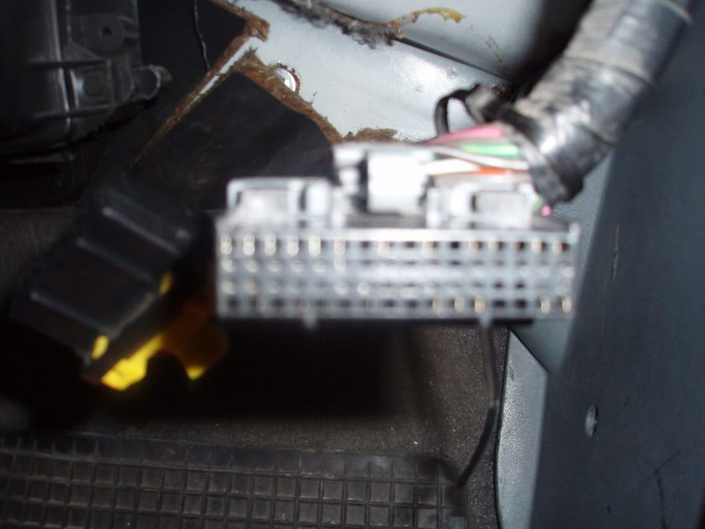

Note: when i disconnect the ECM connection, The F reading voltage at the relay for the primary fan is 11.26 volts. I connect the ecm to the connection and the voltage drops to 0.04volts. To have an idea, the following picture is the connection for the ecm where the green and white plus the gray wire are.
Anyone have had a similar problem? All sensors, relays and connections are in good shape as you seen. My question is, could be the ECM that doesn't ground the fans anymore?
