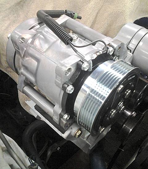

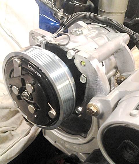

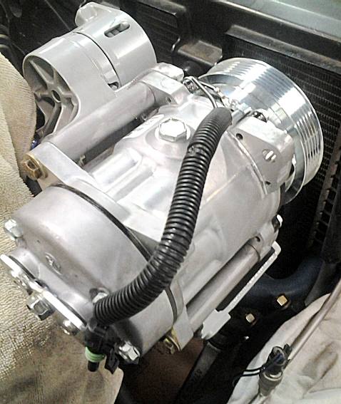

Finished up my conversion today. Replaced the stock R4( third one in 6 years) with a new Sanden FLX7 compressor. Install was very easy, especially if you have already converted to R134a and have the Parallel Flow Condenser ( a must with R134a in my opinion).
The Sanden compressor is model 4864 (SD7H15HD-FLX). I chose this particular compressor because the stock F-body hoses I was using will fit with only a little tweak to the connection at the Accumulator. It is also a 7 piston compressor as opposed to the Sanden 508 (5 piston) that is commonly used in retrofits, and is a little larger in overall capacity. The connector has a built in Diode. I bought mine locally, but they are available on-line as rebuilts or new, and there are also "copies" available. Here's one of the places that had a good price online:
http://www.truckerac.com/sanden-flx7-r17134033708.html
You will need to make some brackets, or buy them already made. The kit is $60 at VintageAir.com, and after doing it manually, I think the kit is an OK value. Hardware alone cost me $20.
http://www.vintageair.com/INSTRUCTIO...s/901805_a.pdf

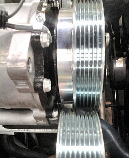

In my application, the Serp belt I had would have been usable, but was at the limit of the "stretch" marks on the tensioner. I bought a belt that was 6K965 vs the 6K980 I was using. It's worth trying your belt before buying a new one.
Charging was as normal for an R134a system. I was seeing temps in the mid to high 30's at the vent, with high pressures at 2 times ambient. Overall, very quiet compared to the R4 that was on it's way out.

This conversion is an awesome idea, the Sanden is a superior design. The only thing that bugs me is the 8 groove pulley, the old R4 uses 6 grooves. It will work fine as is, but personally I just couldn't accept those 2 extra grooves taunting me every time I opened the hood. Certainly the same compressor could be had with the proper pulley.

Not sure, but I would say unlikely. The shaft is likely different.
Sanden makes a wide array of compressors with the 4 moutning ears, I would think it would be easier to get one that has the correct (or close) pulley in the first place.

It might be less noticeable if you spaced the compressor back about 1/8", allowing one of the extra grooves to show on each side of the belt. I wanted all the space I could get on the rear, but spacing it would not be difficult.

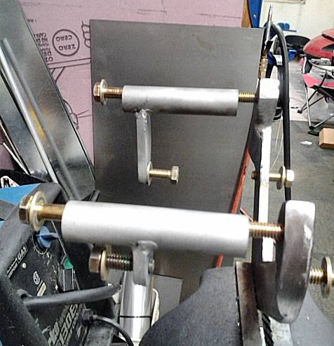

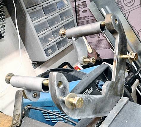

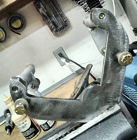

Mild revival from the dead...
In between everything else going on, Ive managed to nearly finish mounts for mine. If the 8rib pulley didn't bother me, I may have finished this sooner.
So far though.... even small progress is at least that... (the hex bolts are not permanent... will find oe looking as time permits)..
Attached Thumbnails R4 to Sanden for Serpentine Systems-img_20150223_224222.jpg   R4 to Sanden for Serpentine Systems-img_20150223_224133.jpg   R4 to Sanden for Serpentine Systems-img_20150223_224148.jpg

Re: R4 to Sanden for Serpentine Systems
Is there any worry of the belt jumping on the 8 rib when its only a six rib belt?
From what I can see, and darby may be better to answer where the belt lies (appears rearward in his pictures), the 6rib pulley is machined out to the front part. Basically it deleted the reward two ribs... if you were to just change pulleys, and used darbys brackets, the 1/4" difference would chuck a belt at startup.
Just for info, mine's been on for 2 1/2 years with no belt issues at all ( in fact no issues for any reason so far!!). Not sure if you can swap the pulleys- don't know if the shaft's and mounting are the same.
I guess that's all we can ask for. I would just be afraid of the belt jumping grooves and getting chewed up.

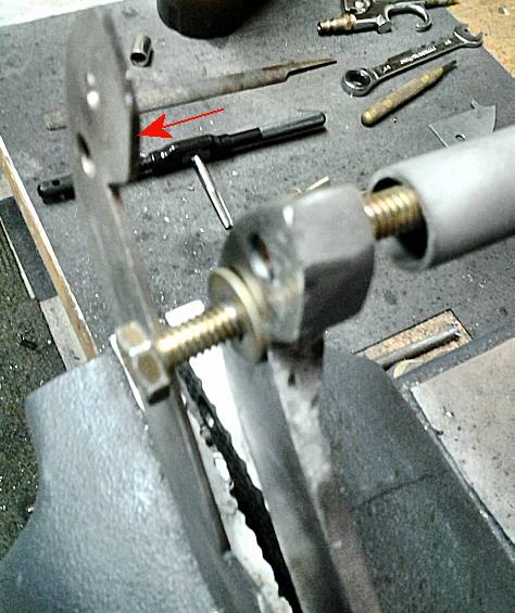

Even with a slight alignment variance, the belt walking would be pretty unlikely unless your belt was near its end and the tensioner spring was shot and revving the engine to the moon.
I was trying (poorly) to explain the difference between the 6 and 8 rib pulley to line the pulley with the others.
A 6 pulley/clutch is available, http://www.truckerac.com/sanden-clut...-65246010.html, and there is a slight thickness difference. I had to set my compressor back ½" to get the pulley in line with the others.
Attached Thumbnails R4 to Sanden for Serpentine Systems-img_20150225_185830.jpg

The brackets I made are still fairly simple (welding required, though). I couldn't get past the ones vintage makes/darby made because it tilts the compressor and my ocd couldn't take the comp not being level (despite mounting angle not affecting operation)... lol
Attached Thumbnails R4 to Sanden for Serpentine Systems-img_20150225_192541.jpg   R4 to Sanden for Serpentine Systems-img_20150225_192353.jpg   R4 to Sanden for Serpentine Systems-img_20150225_192524.jpg
That's not bad though! I would prefer the six rib over the 8 rib.

I did start with thinner brackets and trying to live with the belt centered on the 8 rib but, in the end, it bugged me. Talked to service at truckerac and they suggested the 6rib I linked above. Easy swap with 'loan-a-tool' puller.
Will probably powdercoat brackets cast alum to match my serp mounts to try and keep the look factory-ish. While ocd was kind of joking... I think I do have it with wiring (blower box)...
Attached Thumbnails R4 to Sanden for Serpentine Systems-img_20150225_212725.jpg   R4 to Sanden for Serpentine Systems-blower.jpg
You know, what's funny is I think I'd be ok with it at first, but then it would bug the crap out of me if it wasn't sitting level. I'm again back to the, you want to make another set? hehe
