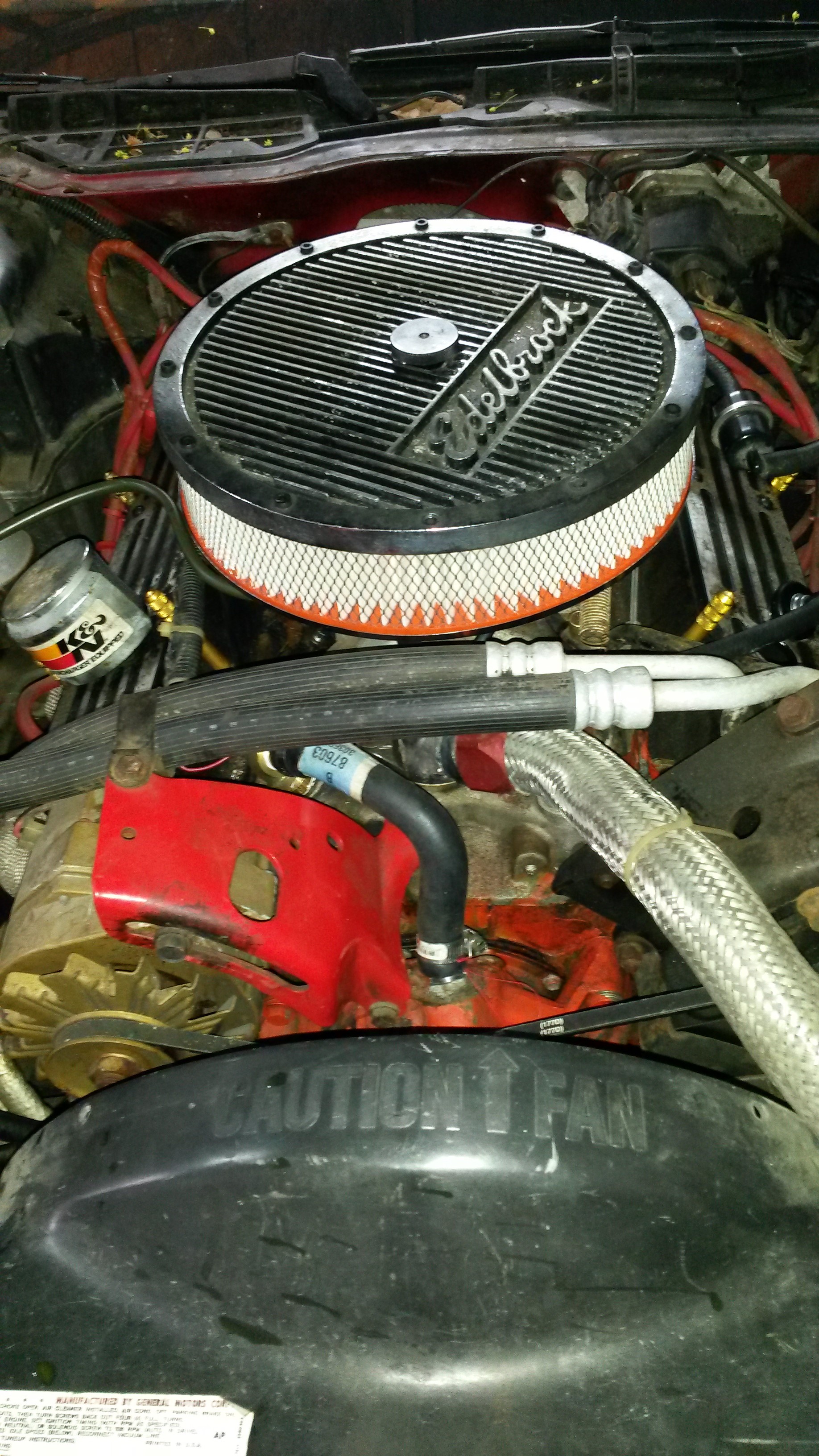

I bought a brass 90 degree and 45 degree fitting for the intake, and found a formed hose with 5/8 and 3/4 ends. The fittings helped aim the hose down towards the water pump.
I prefer the bypass hose, as my engine always runs warmer without it.

Mine is def closer, its like both fittings are right on top of each other!
But I got hose and fittings store and did as you said.
I lucked out cause the hose I used had two molded ends (one 90 and on like 70)....the 3" middle had a sweeping bend. valla....the middle did the ticket,
So I'll run it a couple times to see how it does, but thanks again
