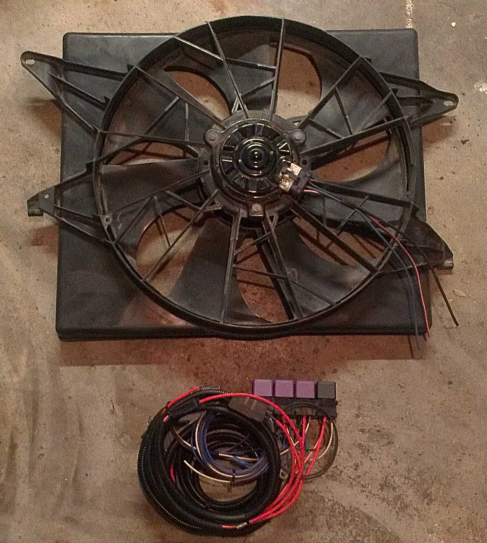

If you want to swap to a HD fan system with 3 speeds, let me know-here's what I've come up with. I have one for sale in the classified section. PM if you have any questions. The 3rd gen fans are horribly inefficient imo.
