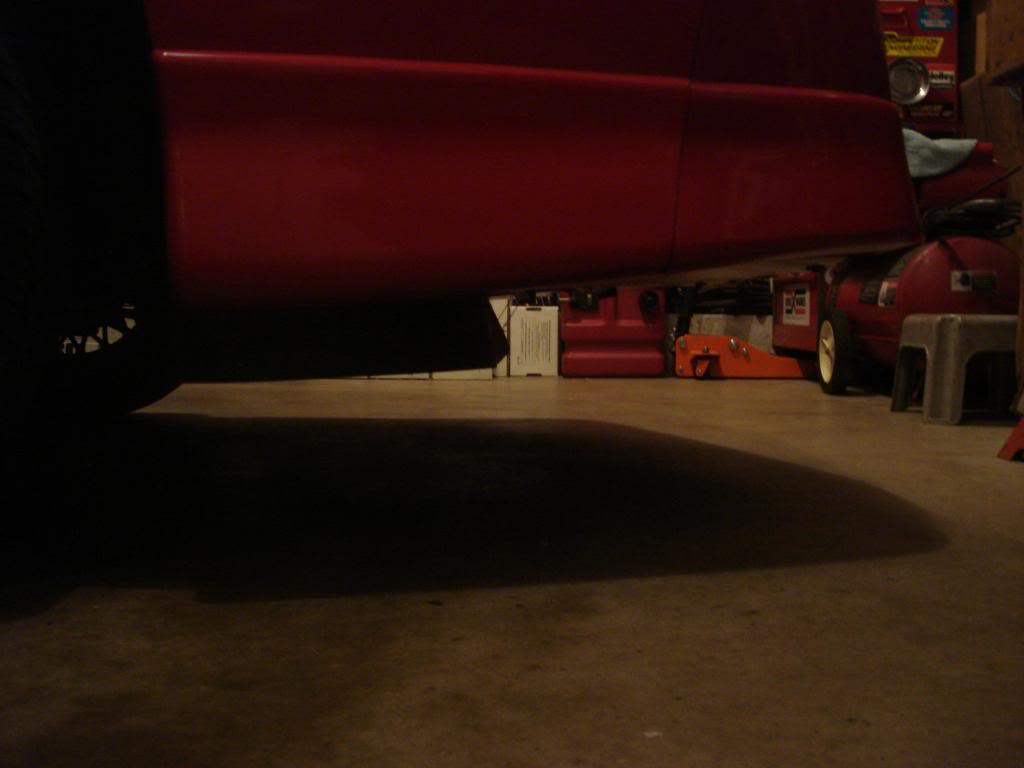

Old Dec 17, 2013 | 05:25 PM
eseibel67's Avatar
Joined: Jul 2009
Posts: 2,328
From: Kitchener, ON
Car: 1988 GTA
Engine: LB9
Axle/Gears: 3.45
Re: engine over heating?
I fixed the old air dam with some old leftover wainscotting scrap and mechanic's wire. This was on an 88 GTA:
