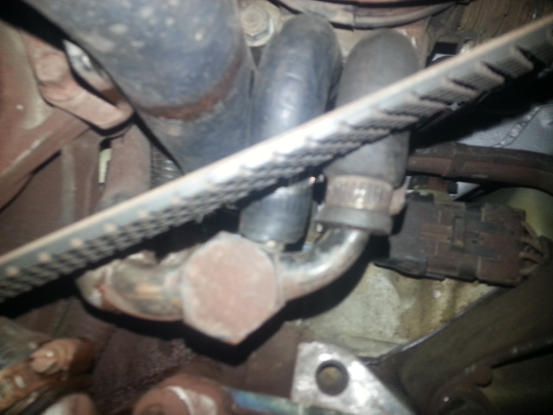

Okay I have an 88 Firebird and I need to know what part this is. It's leaking coolant from it. I noticed she was running a tad high on temp and when I got home I noticed I Was leaking coolant. So if anyone could let me know the name of this part so I could get a replacement part. Thanks guys.

It's an intake pre-heater pipe. Used to warm the air going into the intake manifold. Got mine from a Pick-N-Pull.
