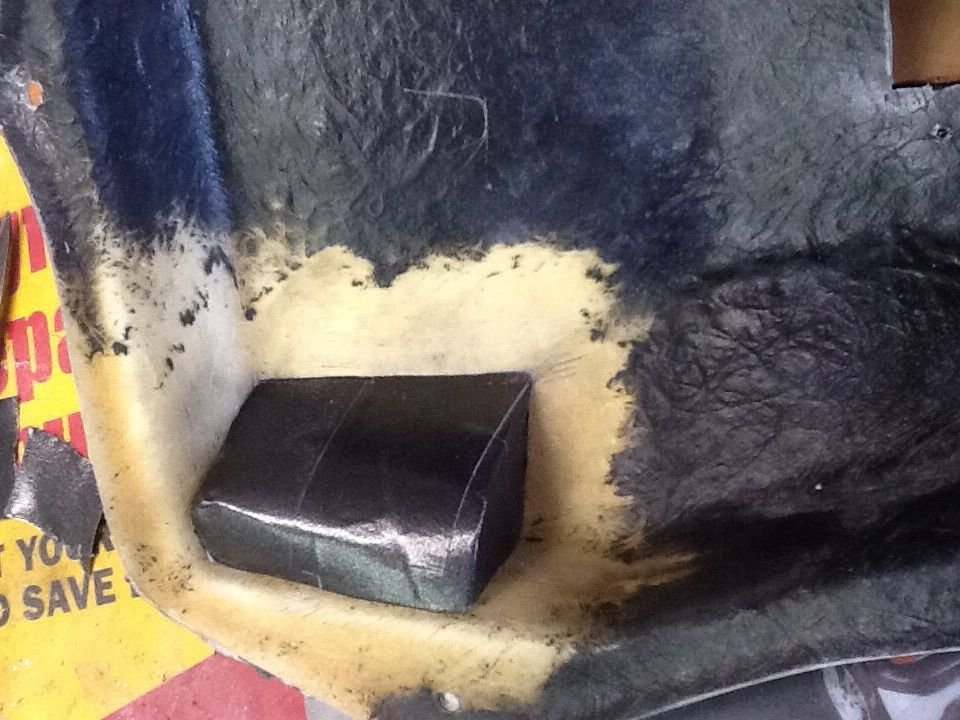

I had never glassed before so, decided this would be a great learning exsperience. I had to cut according to my needs then make a small section mold. Then start glassing.
Here are some pictures in progress.

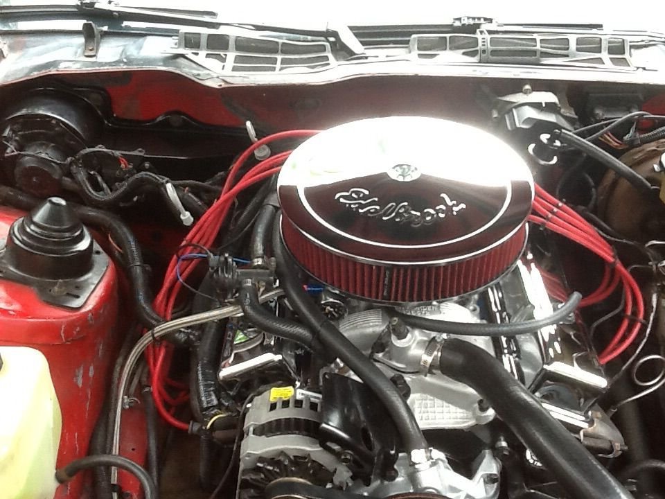

Here are some pictures completed and if you look closely you can see in the one pictured how the number two cylinder head pipe comes up over and real close too the heater box near the firewall.
