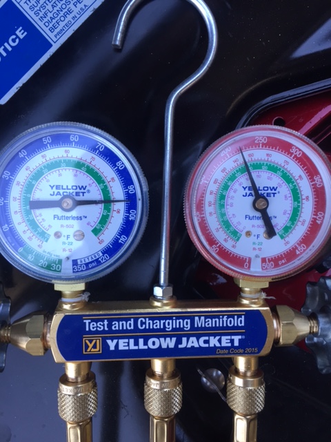

Hey Reid I got the adapter line and That didnt do the trick either. My issue is that the button to open line in the valve is a good 1/2 inch into the fitting. Its not right flush or even close to the top of the high side fitting. Here is another pic.

Ok. Ive got some updates.
I found the adapter I needed. Robinair Fitting # 18143 A/C Access Valve Adapter.
The compressor pressure releif vavle opened up and blew out all the freon before I had the adapter.
So I bought a new compressor and a Ford red orifice tube to start getting rid of variables.
Installed them both this morning and put an 80% charge of 2.25 lbs of 406 in it.
The gauge readings I got when I started the car were still not where I expected them to be so here are some pics of the gauges.
Currently it is 70 degrees outside and humidity at 44%.
As you can see the accumulator and low side line are icing over and the ac feels amazing but form my understanding the low side pressure shouldn't be where its at.
Any Ideas?
