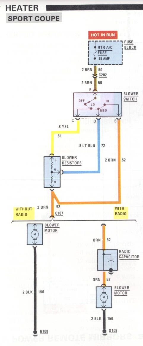

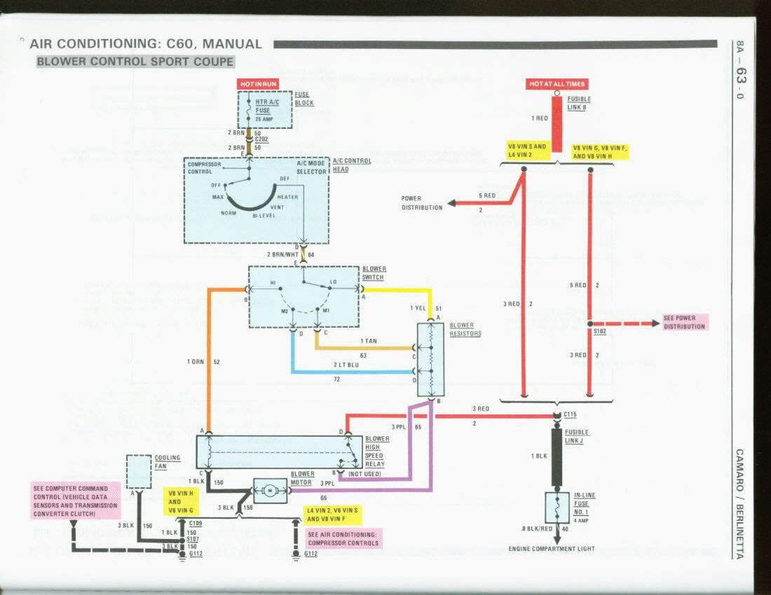

The blowers for AC and non AC are different. Depending on the year AC units had a 4 wire resistor pack and the non AC is a 3 wire pack. 4 speeds vs 3. Also the AC uses a relay for the highest speed while the non AC doesn't. Its easy enough to adapt the AC harness to the non AC blower. All you'll need is a relay and to correctly pin the AC harness to the non AC resistor pack. I'll post of the drawings when I can.

Re: AC Cleanup and Removal
Non AC
AC

It might also be possible to adapt the 4-wire resistor bank into the factory non-AC housing. Then the AC harness would plug right in just as the aftermarket unit does. This is the route I'll explore before I decide exactly what I'm going to do. At any rate I'll have to add a relay as I've already modified the original AC harness that came with the chassis.
