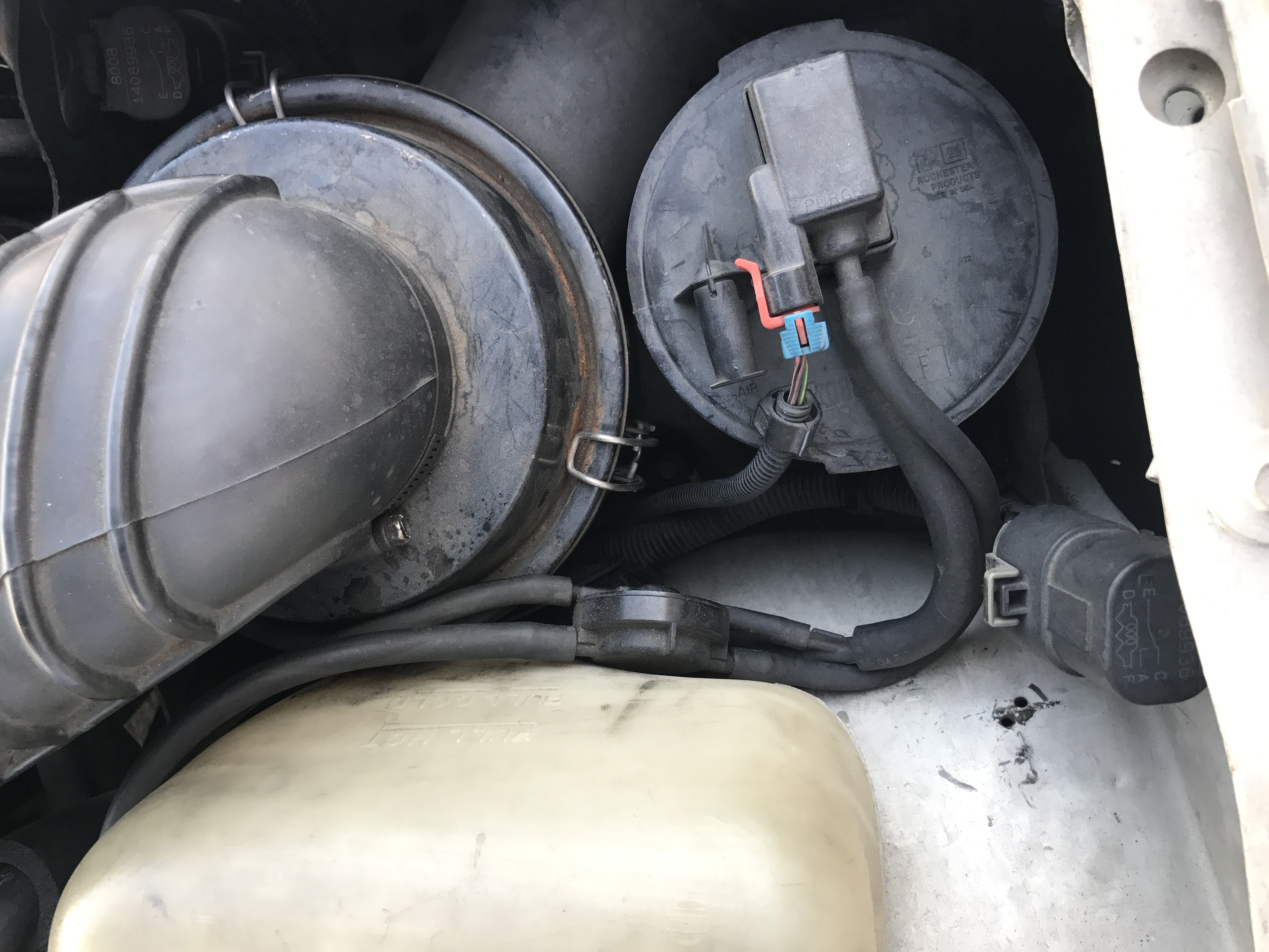

Old Apr 19, 2017 | 01:10 AM
henryd3's Avatar
iTrader: (128)
Joined: Aug 2009
Posts: 1,821
Likes: 41
From: Central California
Car: 92 Camaro RS
Engine: LO3
Axle/Gears: stock
Re: NEED HELP! OVERHEATING
Each fan has a relay. The green and white wire going to the relay is grounded by either the ECM or the fan switch. If you ground out those wires yourself both the fans will run every time the key is on. Well, that's how the Camaros work. assume firebirds are the same?
Old Apr 19, 2017 | 07:54 AM
Jbuchanan's Avatar
Joined: Mar 2017
Posts: 528
Likes: 46
From: Sweet home Alabama
Car: 1987 GTA
Engine: 5.0
Transmission: Automatic
Yep green and white, on my 87 they are both in front of the air cleaner. Take the lid off unplug the relays and make a jumper in-between the green and white. I put a 25 amp fuse in my jumper. I hate doing things like this but I was at the end of my rope.
Here's a photo of my air cleaner. I can see only one relay in front of the air cleaner canister,there is another near the fender near the overflow bottle. I am not sure if these are fan relays and don't have my service manual yet. The wires look green pink and orange
