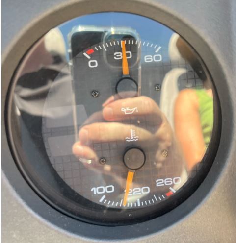

Just ran across this thread, good pic of the plastic that keeps engine cool. BTW - was out driving last few days, 95 degrees out and blazing sun. with a/c on, my temp never gets to 200. I forget the range on the analog guage, but its in the middle. so with both fans running, it never gets 220 when I'm not in heavy traffic.

I remembered our conversation a few weeks back and snapped a photo. This was 100F, cruising at 65mph, A/C on max. Make sure you have all of your air dams and other air flow direction plastic that is below the car in place.
