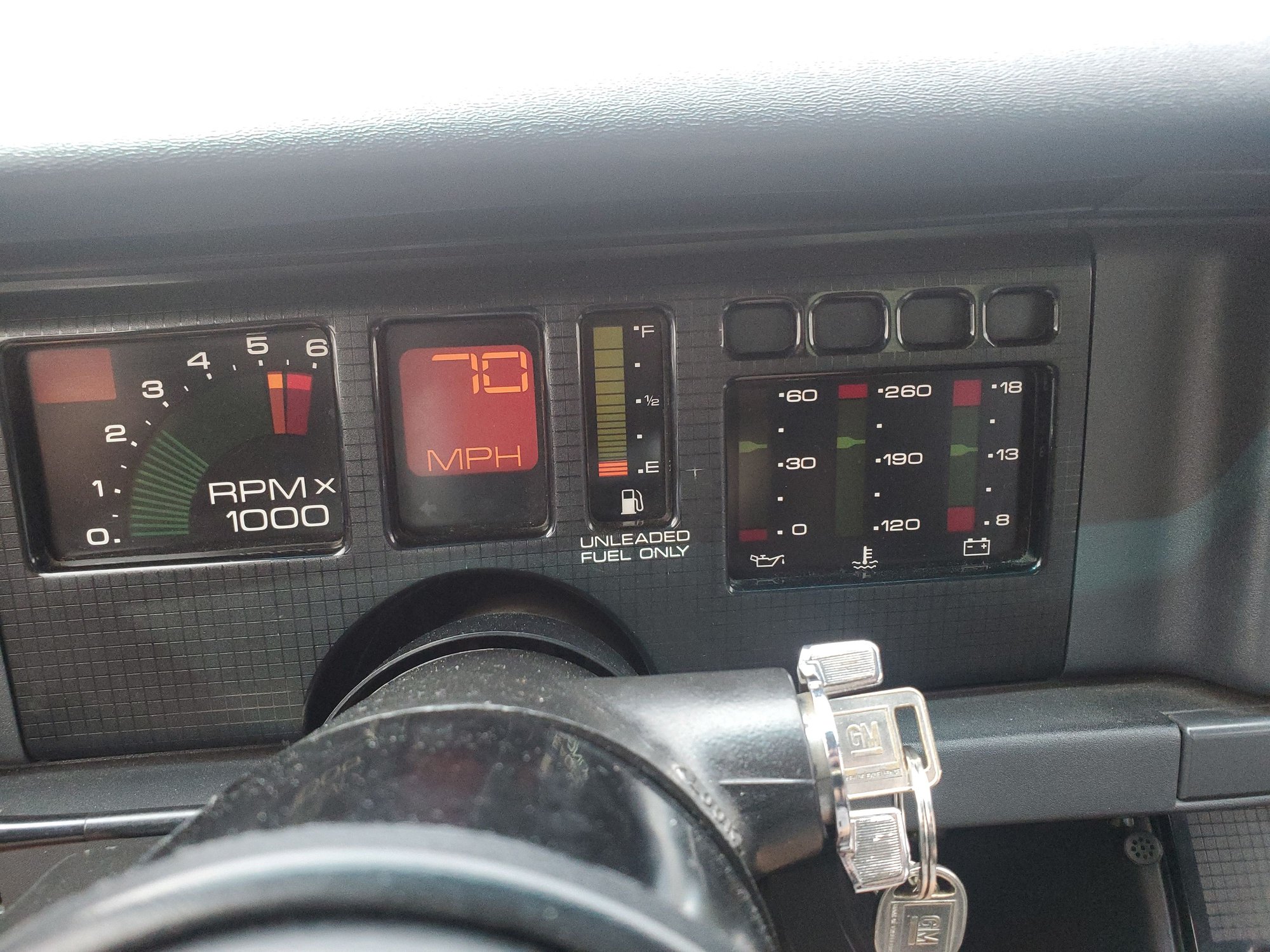

Hey everyone at TGO, I've got an overheating issue I've been dealing with for a long time of owning my 88 L98 GTA... Hoping someone here can help me out.
A few years ago I replaced everything - Factory replacement water pump, 180 t-stat, radiator, hoses + LS1 fans, lower temp fan switch/chip from Tuned Performance.
If I drive on the freeway without AC it will be between 190-220, but if I turn on the AC it can reach 230+... My Air dam is intact but looks kinda bent and I've read that maybe I need the 3 piece one? It's just a flat 1-piece, not the V-style I've heard about.
Here is a pic of 2 days ago, 94 degrees at about 70mph, that seems too hot. (I've checked the upper rad hose with temp scanner and the gauge seems to be correct with it's readings).

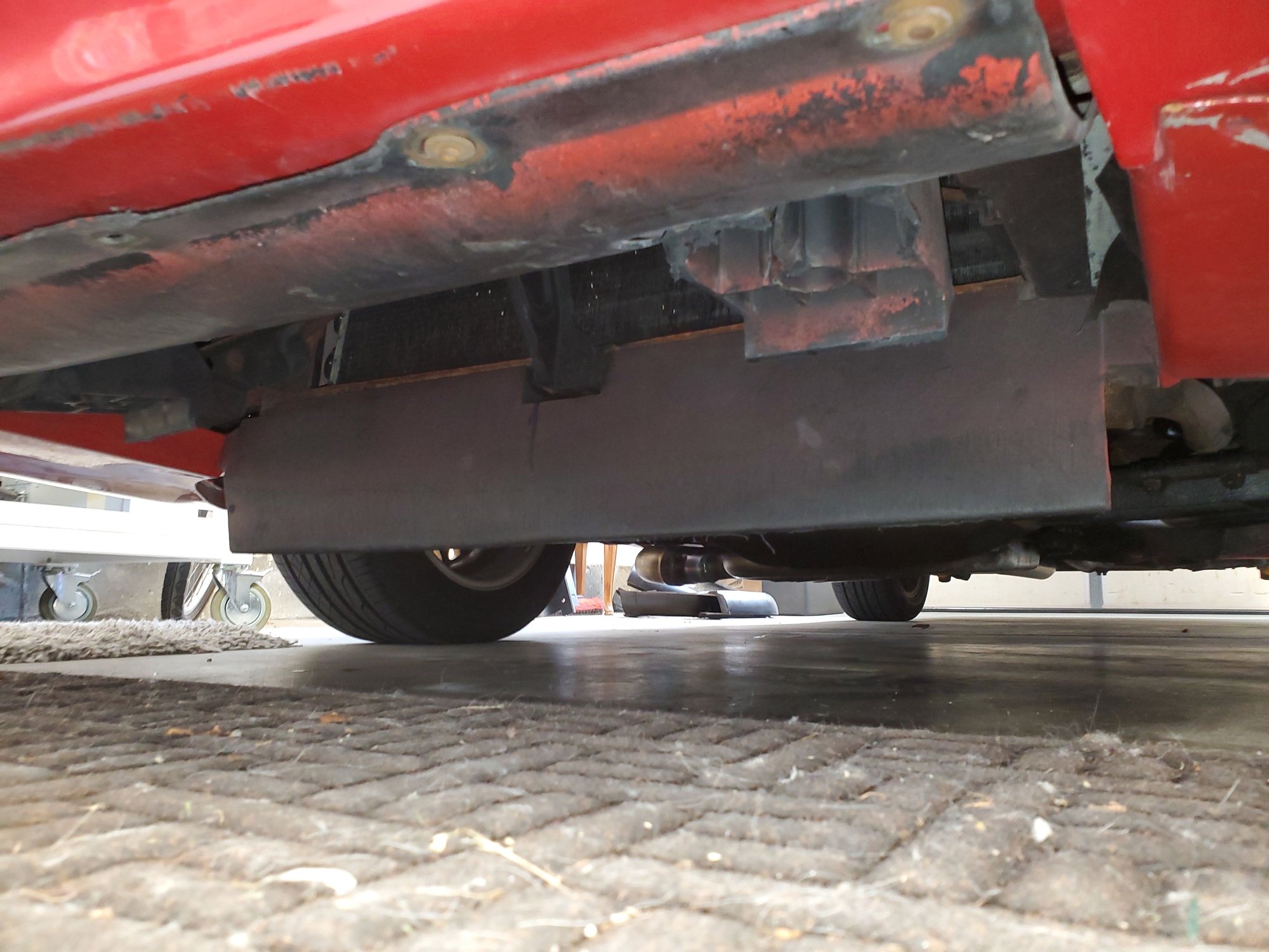

Here is a pic of the air dam, I think I'm missing 2 side pieces?..

Update, found I'm missing the 2 side pieces, as seen in this thread here: https://www.thirdgen.org/forums/body...installed.html
I'm going to buy them and see how it effects the temps.

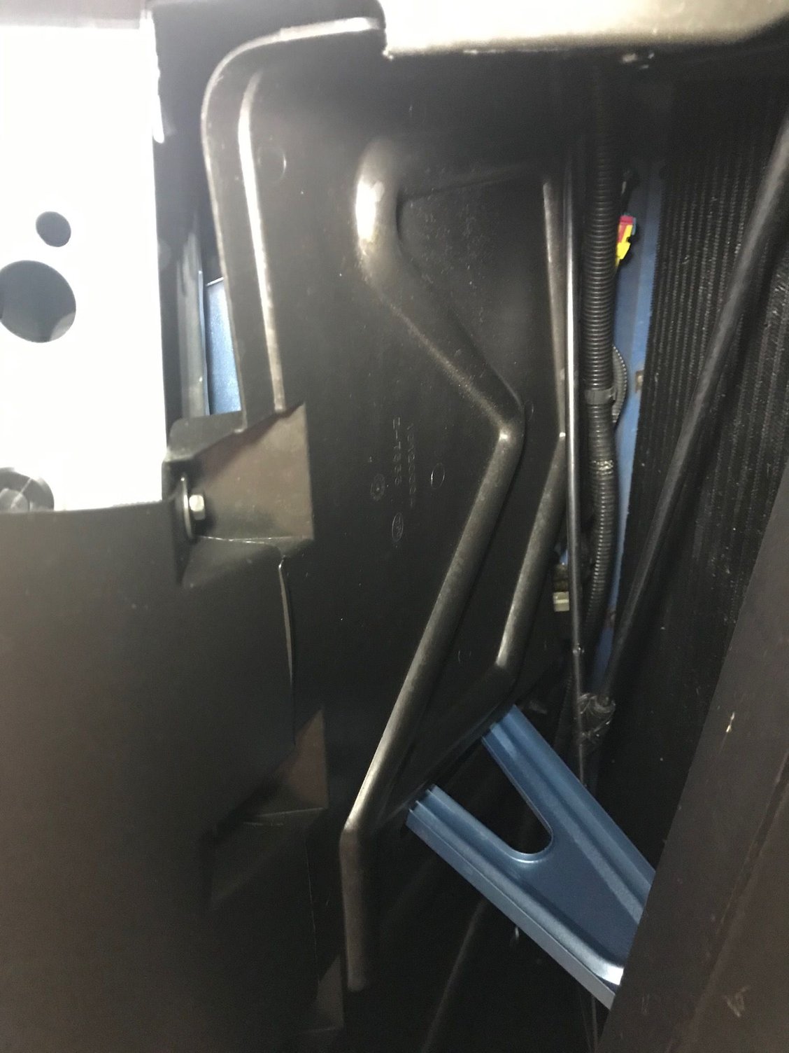

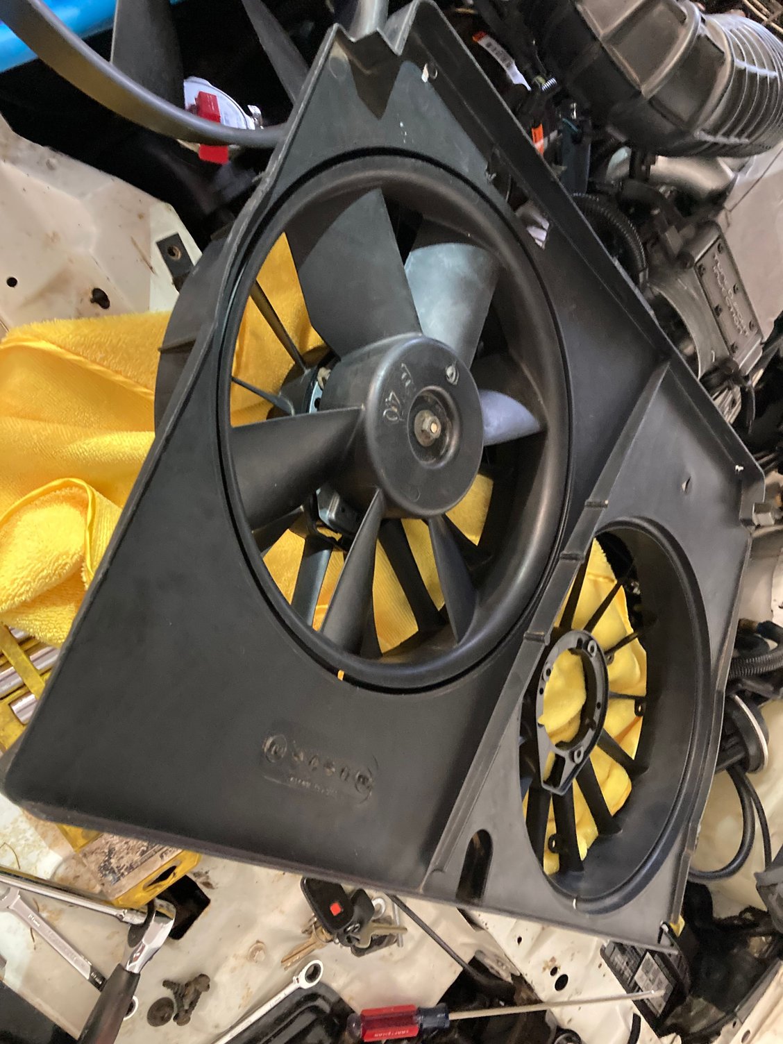

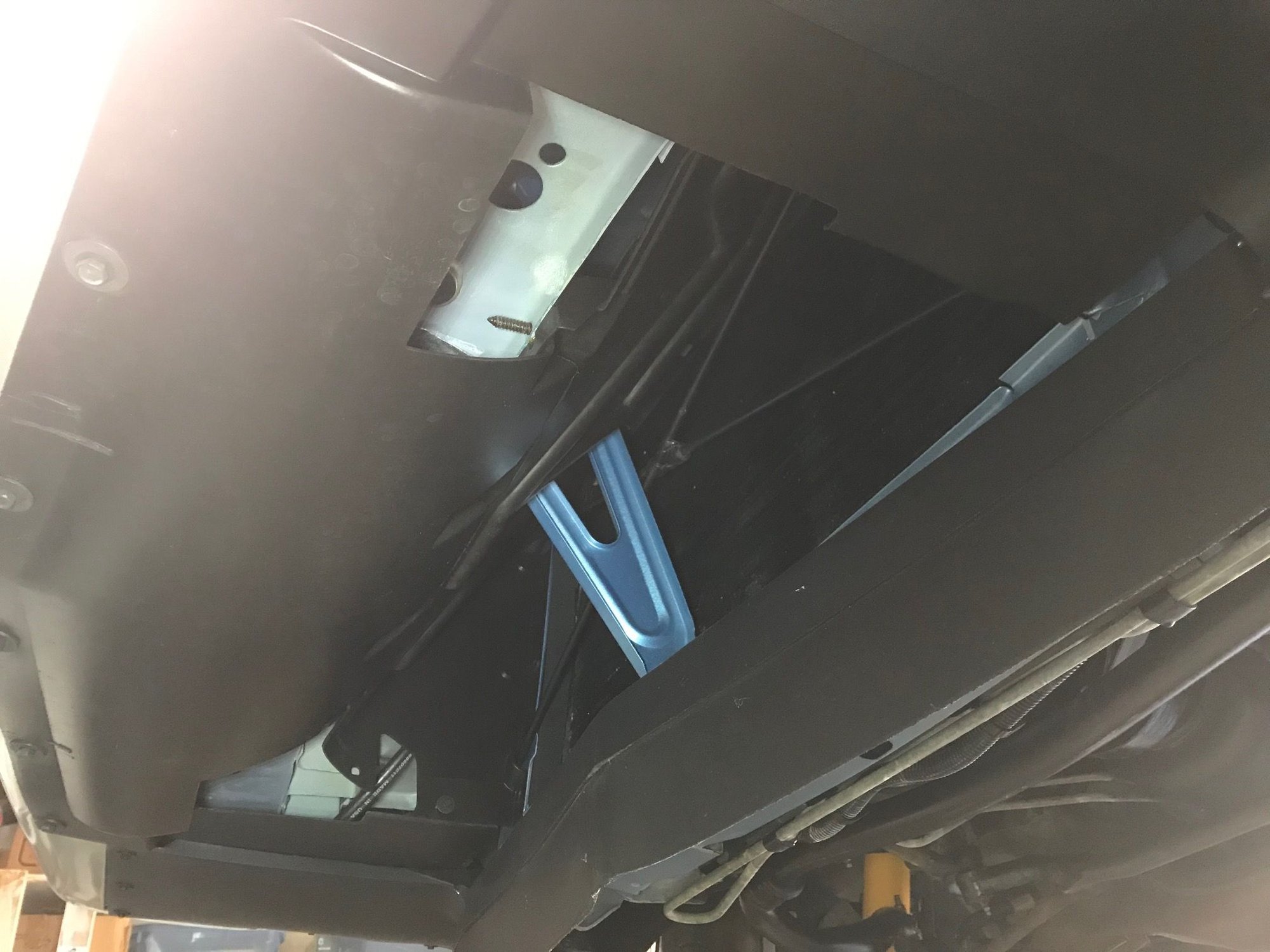

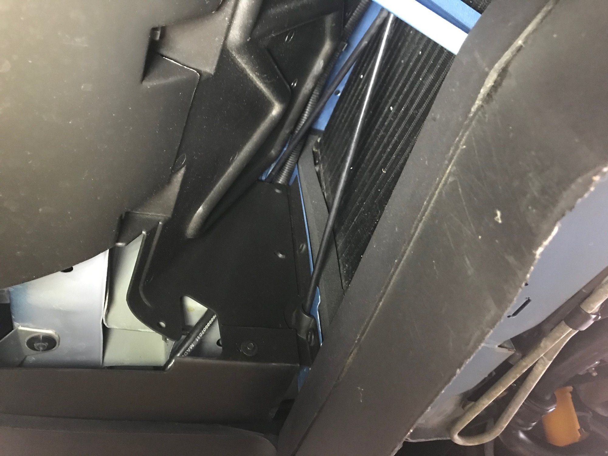

There is a whole system going on in that area, to direct airflow up to and thru the radiator, and also insulation to prevent it air from going around the radiator. Here are a few photos of what should be there.

Thanks for the pics LiquidBlue! I only wish mine was as clean as your's lol, I know I'm missing those 2 side pieces of the air dam and was lucky to find a set on ebay that I purchased today + new bolt kit from Hawk's.
As for other pieces I also noticed I'm missing the foam/insulation pieces that prevent the air from going around - I'll get some from Home Depot/Lowe's to close the gap.

I'm not sure if those 2 pieces will make much of a difference? I think the main one is the middle piece. Try and see though.
I removed the upper duct work LB posted in favor of a tranny / power steering cooler and a pusher fan and so far no adverse issues. and i only have the main middle air dam....I hover at 220 at standing idle but it drops below that while driving...perhaps to cool actually lol
But yours is a T/A vs my Formula.... so Its possible those pieces are more important for it.

I do have the piece that is part of the bumper thankfully.
Yeah the condenser is probably one of the few factory parts remaining and at this point I'm starting to suspect it.
I had the same thought that those 2 side pieces probably won't make much of a difference, but figured it was easier to just bolt those on first and scratch it off the list before I replace the condenser.

I got the 2 side pieces on, and while it did seem to help a little bit it still gets a bit hot for my liking.

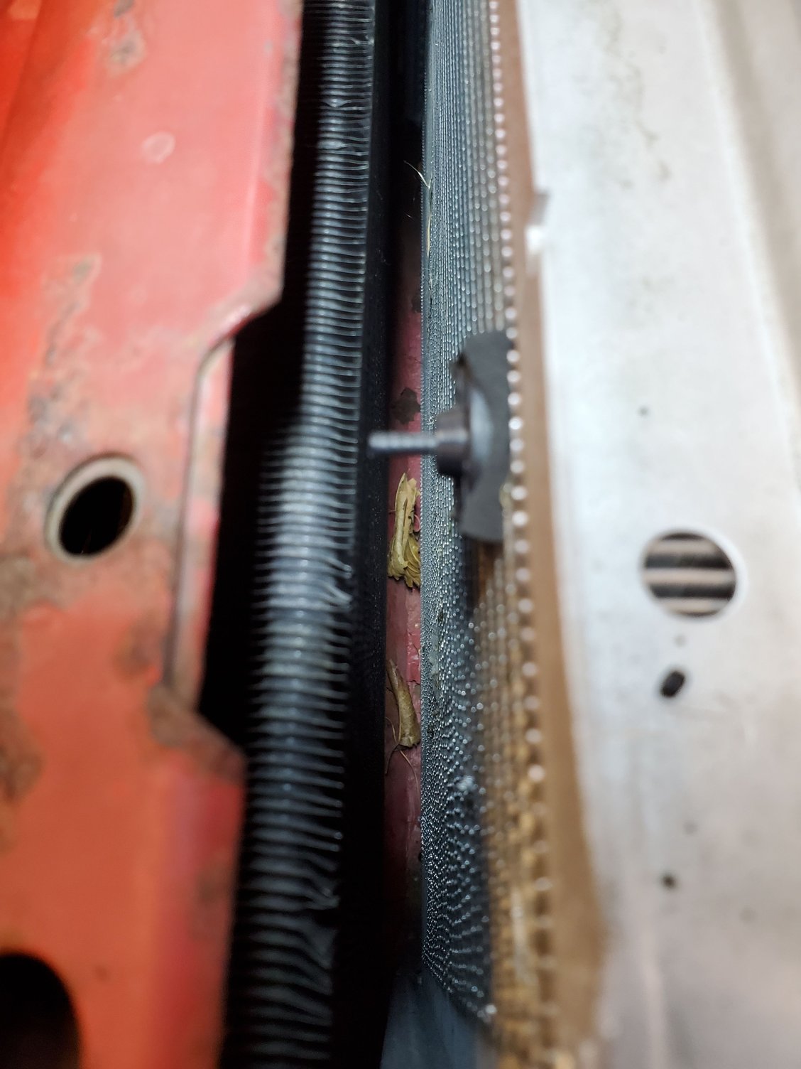

you can work on the condenser while it is still attached to a/c so you don't have to mess with the a/c. get a "comb" and carefully open up the bent cooling fins. its very, very tedious, to get to the other side, remove radiator. maybe while you are doing all that you will find something else like some old leaves, who knows...... Here is what I'm talking about. https://www.amazon.com/gp/product/B00ECV5Y9A/ref=ppx_yo_dt_b_search_asin_title?ie=UTF8&psc=1
EDIT: bt
w - it sounds like your a/c is warming up because the condensor is not working - I say that because you are also over heating. once again points to blocked airflow. as you a/c runs, the condenser gets hotter and hotter, the fridgerant never cools off,, so its continually looping, never cooling off, then you start to get over heated. sort of adds up

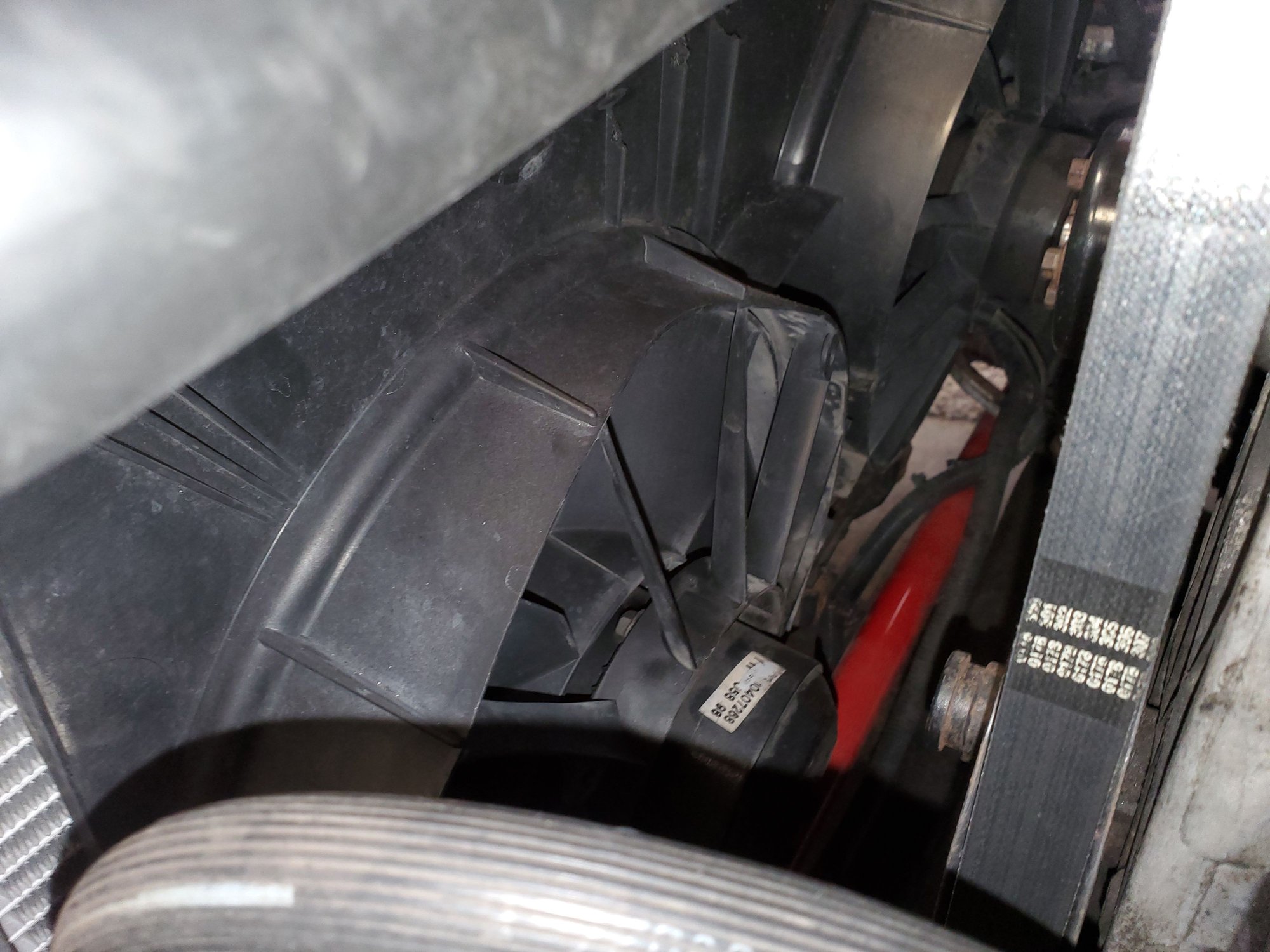

Is your system still running R-12? Can't get it anymore, not easily anyway. If so, I would avoid messing with it if possible. Have you had A/C pressure tested to make sure it is in-line with specs? That could also be another reason it isn't working after a while. There isn't really anything to gunk up a condenser unless it has been not serviced correctly. The A/C oil can get old and maybe it can start gunking up I suppose, don't really know the answer to that.
I'd first start by making sure you have all airflow working the way the car was meant. These cars do run hot at idle, but going down the road, it should cool down pretty good. even in 95 degree weather. Mine actually runs cooler at idle with the a/c on because the 2nd fan is engaged.
Have you flushed your cooling system (including opening the block holes) and made certain the thermostat is functioning correctly? You could have some clogged water jackets that need flushed, or the radiator itself, but I'd still make sure your condenser is allowing air to flow thru. If you shine a light up in there, you should be able to see thru it and see the radiator.
If you end up having to tear open your a/c system, consider converting to R-134a - I was able to do it with good results. Some others not so good. I think alot of it depends on how tedious you are with the conversion.
https://www.thirdgen.org/forums/cooling/762352-r22-r134-conversion-here.html?ispreloading=1
BTW - Here is how a dual fa
n operates (1990)
fired her up, turned on the a/c (engine cold) both fans turn on.
turn off a/c, drive side fan remains on for about 1 min, then turns off
turn a/c back on, drive side fan back on, pass side off. about 1 min later, pass side turns on
ac off, temp now 110, turn back a/c on, driver side on immediately, pass side on in about 30 sec this time
ac off, temp now 120, turn back on, driver on immediately, pass side on in about 15 sec
ac off, let temp rise about 220, around 230, driver fan comes on. (seems too late to me in Austin) turn on a/c, pass fan turns on immediately
ac on, temp falls under 220, turn off a/c. pass fan off right away, drive side off in about 1 min
temp still under 220, a/c back on, both fans turn on immediately

Originally Posted by LiquidBlue
Well, first make sure your condenser isn't blocking airflow and after that you can take the next step. But I wouldn't rule out those side trims on the side of the radiator. The whole system is designed to bring air up, in and thur the condenser and then thru the radiator. All of that plastic creates a tunnel to make that happen. Hopefully once your overheating issue is solved, your a/c issue will also get fixed.
EDIT: BTW, since you are already converted to r134, then it would be easier just to take things apart IF IT TURNS OUT that your condenser needs attention. Just be certain to change out your drier and vacuum the system properly and if you change the condenser, add proper amount of oil back in. The orfice then used could be examined at this point, it could be part of what is going on with your a/c trouble. anyway, all of that is a entirely different issue. stay focused on your cooling problem first. a/c doesn't matter if you can't even drive the car!
I went to Lowe's and bought some condenser brush + cleaner kit. I'll try to tackle that in the next day or two.
I also went to my local junkyard and pulled some radiator side baffles from a 90s Buick (rubber/felt-like material) that I can trim to make it fit the side openings. Once that's on the air is completely set to only go through the condenser/rad.
Originally Posted by 1989karr
For some reason my response wrnt into an old thread lol
How are your LS1 fans setup?
Are they wired with the stock dual fan wiring?
Are they both coming on?
Both fans do come on at the correct temps/AC and they are using the stock dual fan wiring (not sure if that was supposed to be changed).
Old Aug 9, 2021 | 06:15 PM
1989karr's Avatar
Joined: Feb 2005
Posts: 2,511
Likes: 202
From: Hawaii
Engine: 3.4 / 5.0
Transmission: 700-R4
Axle/Gears: 3.42 / 3.42
Re: Car overheats either with long drive or AC on.
If your ac got too hot ' didn't cool properly..., the pressure would get too high and cause the compressor to kick off and it would stop cooling.....does the ac stay cold:?
if the ac stays cold then I want to think its non -ac related but rather a deficiency somewhere in the cooling system. im personally betting on the fact that the ac turning on just brings out a cooling system problem.... Im on a computer rather than my phone now lol
Couple things id look at
1. pop the top radiator support / shroud and see if there's crud between the condenser and radiator and see if the radiator fins are clogged as well....although I don't think it'll be that bad / I don't think this s your prob but worth checking
2. is it the correct water pump you installed? 1988 so I think that's serp belt....so you'd need a reverse rotation pump
3. thermostat opening all the way?
4. Clogged / partially clogged cooling system....If you haven't changed the coolant sicne you did the pump might as well o it now as its time...flush it out, run water through it and see if gunk comes out....
- my S-10 had cooling issues for YEARS..... many coolant changers, t stats, etc... did not fix the issue.... flushed it out a couple years ago and black crud from I dunno what...sealer?? came out from the block...I hooked up a hose barb to the waterpump opening and flushed it....I was there for a few hours flushing black them bron gunk out.....never had a cooling issue again. somehow the gunk got dislodged and finally came out when I flushed it....
5. bad sensor for the gauge? My camry had a wonky sensor..itd read hotter than it was once it got to a certain temp.
6. Clogged radiator....if its old maybe you need to just replace or remove and back flush it etc... .could have hard water deposit that clogged the middle etc..
7. Do you have pics of your fan setup? LT1 / LS1 fans are supposed to be great. the motors are like TPI motors but are stronger and pull more air plus the shroud... others have plugged in the TPI wiring with no issues. So they should be able to cool it perfectly. did you keep the shroud I ntact?

For some reason. only now I am able to see some of your and LB other posts / answers like how the ac gets warmer etc... does the ac get cooler as you drive / freeway seeds? If so then you could just be low on refrigerant....134 gets warmer at stops in converted cars... I stil lfeel its not your huge problem though.
I can see the tubes in your condenser so I wouldn't think its that horribly clogged. Again, see if theres crud in-between the condenser and radiator.
Are your fans operating correctly ?They should blow pretty hard... I had a failing motor that would work but would not blow a lot of air as it was weak..replacing the motor made a huge difference in how the fan operated.

The AC does stay cold the whole time, however it does get a bit warmer when the temps are hot.
1. I cleaned that area out originally when I replaced the radiator, but I did check again and took a pic.

well that def looks clean! that eliminates the clogging / dirt part i feel between the condenser......the radiator is also new / nice so thats probably not clogged either.... if the ac is cold I can't imagine its causing issues for your car to heat up. But clean the condenser like LB said.

I will clean out the condenser tomorrow and get the custom side baffles installed.

I ended up using some condenser cleaner foam and hosed it out, seemed to help on the drive today with AC Max doing 65-75mph for 10min on the highway then 15min of city driving. (Ambient was 87 degrees).

Originally Posted by vinny R
Do you have a lower gear rearend? Like a 3:43 or something.
I'm honestly not sure what gears I have because I've never opened up the rear end.. It is a factory 9-bolt, I'm planning to when I order a diff cover from TA to change the fluid.
The rpms have always seemed a bit high for freeway imo.
I noticed your RPMs in your photo. I have 3:43 gears and I am @ the same RPM @ 70. My car acts just likes yours, it always has. I also have a complete new stock cooling system. I always thought it was odd that it would cool down while idling at a traffic light. My car runs @180-190 around town but once up to cruising speed, I like to run 80 mph and my RPMs are up to about 2800, I go up to about 220. I have flushed and cleaned the condenser multiple times and I have just chalked mine up to the lower gear turning higher RPMs for the prolonged period of time. These cars were made to run hot and 220 seems normal so I never really worried but I always wondered why the cars cooling system acts this way.
You could find your gear ratio by lifting the rearend of the car, mark the tire and the driveshaft. Rotate the tire 1 complete revolution and while doing this count the how many times the drive shaft rotates. If the drive shaft rotates 2 3/4 turns to 1 tire revolution, you have a 2:73 or so ratio.
Interesting, are the 3.43 gears stock? I'll definitely check that as well. Unfortunately my RPO sheet is nowhere to be found... I've been meaning to reach out to one of those heritage/archive sites to see if they can give me the info on my VIN.
I will have to report back what I find, maybe the extended high RPMs really are just the source of the heat. Maybe all due to the 55MPH national highway speed that was still around? lol
Great to hear you are up and running! I'd still have a look at your condenser fins, that will help out with max a/c cooling too. Enjoy the ride!!
I did take a look and most of them looked straight from what I could see. Definitely appreciate all the help!
I think you have the wrong air dam going on under there ,88 used a one pc. air dam on the Trans Am .I also use a one pc.
I thought they changed it to a 3 piece later? I'm not sure but I was able to get the 2 side pieces off ebay and they matched up to my existing one. (Previous owner must have changed it).

At idle / in drive with the fans / ac going and the headlights on and brake applied....I noticed the charging to be underdesireable....I tested it and let it idle a lot and shut it down and started it back up...battery seemed weak.......soooo Im guessing in this circumstance it could kill the battery.... that won;t happen a lot but still...........
Well, I was able to find a shop that will upgrade the CS130 alternators to a good 150 to 200 amps...but if I recall, when you do that you need to upgrade wiring etc?? I don;t want to do that...plus Id like to be able to get an alternator easily if mine fails...soooo what I am doing is I pulled the fans back out and i am replacing one LS motor with the stock TPI motor. It should cool plenty enough really though as the shrouds themselves make a huge difference!
I have noticed the weak charging as well.. Never enough to kill my battery thankfully but back when my fans were running all the time I definitely saw it on those hot evenings.
I like that idea! Did the TPI fan bolt up just fine?
Oh yeah, fits PERFECT...the housings are the same size etc..same connection...they just don;t spin as fast but i don;t think itll make a huge difference.... The LS motors are just higher amp units ad cost a lot more!
For the record, people said that LT1 fans are the same minus the design of the removeable shroud with vents....etc.... incorrect...the LT1 fan shroud is thicker and I don;t think it will fit as nice as the LS fans because of that.
