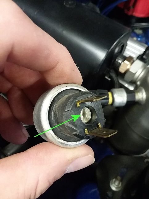

  • Get High Pressure Safety switch that mounts on Compressor if you don't have one already
  • Pressure switch that mounts to accumulator for r134

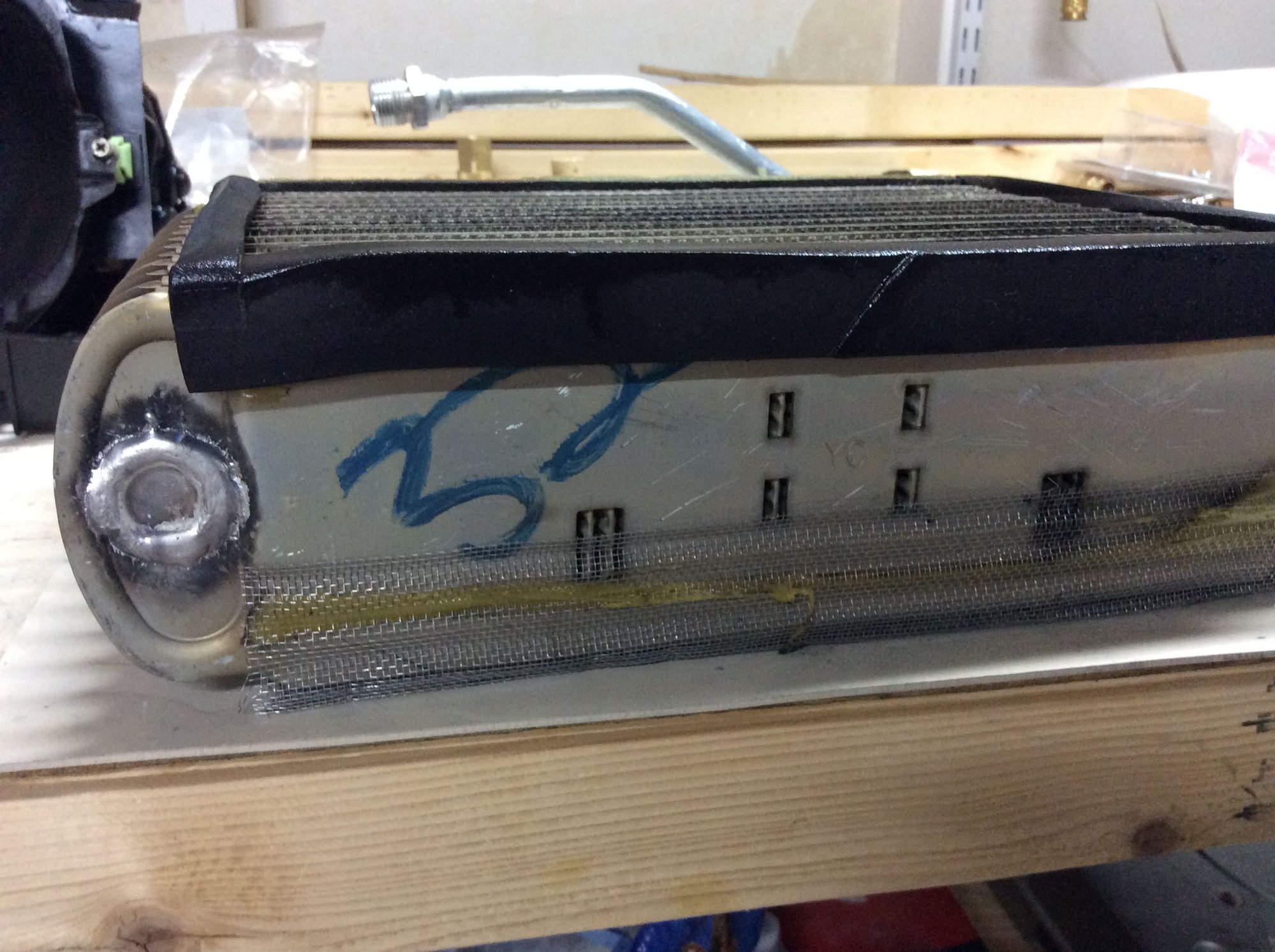

first off, evaporator removal. not gonna try to flush it while in car.
hard part is keeping gasket in tact. not shown in photo
where does one source this green foam?
nice bug catcher

There should be an adjustment screw in between the two electrical connection terminals. I would bet those two switches are the exact same part, just preset to different pressures.
The 28/33 listed on the R12 switch is just the tolerance of the cut out pressure setting. It will cut out somewhere between 28 and 33psi and cut back in somewhere between 37 and 47psi. It's a mechanical switch that isn't terribly precise (although it's precise enough for this purpose).

round one of flushing. evap, then condenser. this system sat for 25 years. evap was the most oily. once evap fluid clear, continued to flush it and then reuse clear fluid to flush condenser. evap took about 6 flushes before clear, condenser 3. will use ac flush gun next. for this round, hook up air and set to 40psi at end of hose. pictures tell the rest of the story
BTW - color of your oil is a clue to the condition of your system. color below appears to be good. darker colors, indicative something is wrong.

MORE ON FLUSHING - when I flushed, for the evap, I put fluid in and then turned the evap on all sides for about 10 min a side. (was doing other things and am in no hurry, so why not) With the condenser, I pushed the fluid thru a little, and let sit for 10 minutes, and kept pushing thru a little more. Also used what one person refered to as the pop method. plug the hole and push air, then release other end after building up pressure. so I did a lot of little different tricks to try to remove as much junk as possible, which really turned out to be old mineral oil. So I'm off to a good start.

Originally Posted by TransamGTA350
There should be an adjustment screw in between the two electrical connection terminals. I would bet those two switches are the exact same part, just preset to different pressures..
For anyone wondering, here is the pressure adjustment screw for the r12 switch.
