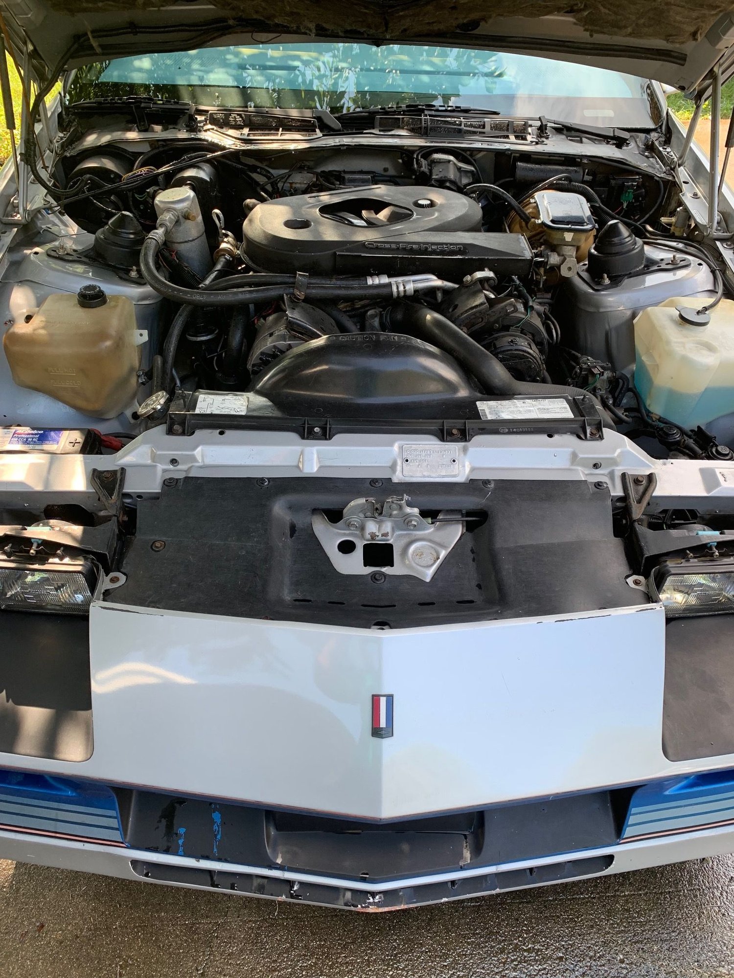

I have an 82 Indy Pace Car and getting ready to fix a backyard mechanic botch job...He installed the oil pan gasket upside down so the lip is outside the pan and it leaks in multiple areas..There is a bump out area on hte wrong side of hte pan so it's basically upside down..
I haven't done an oil pan gasket ever...any help please make a suggestion..

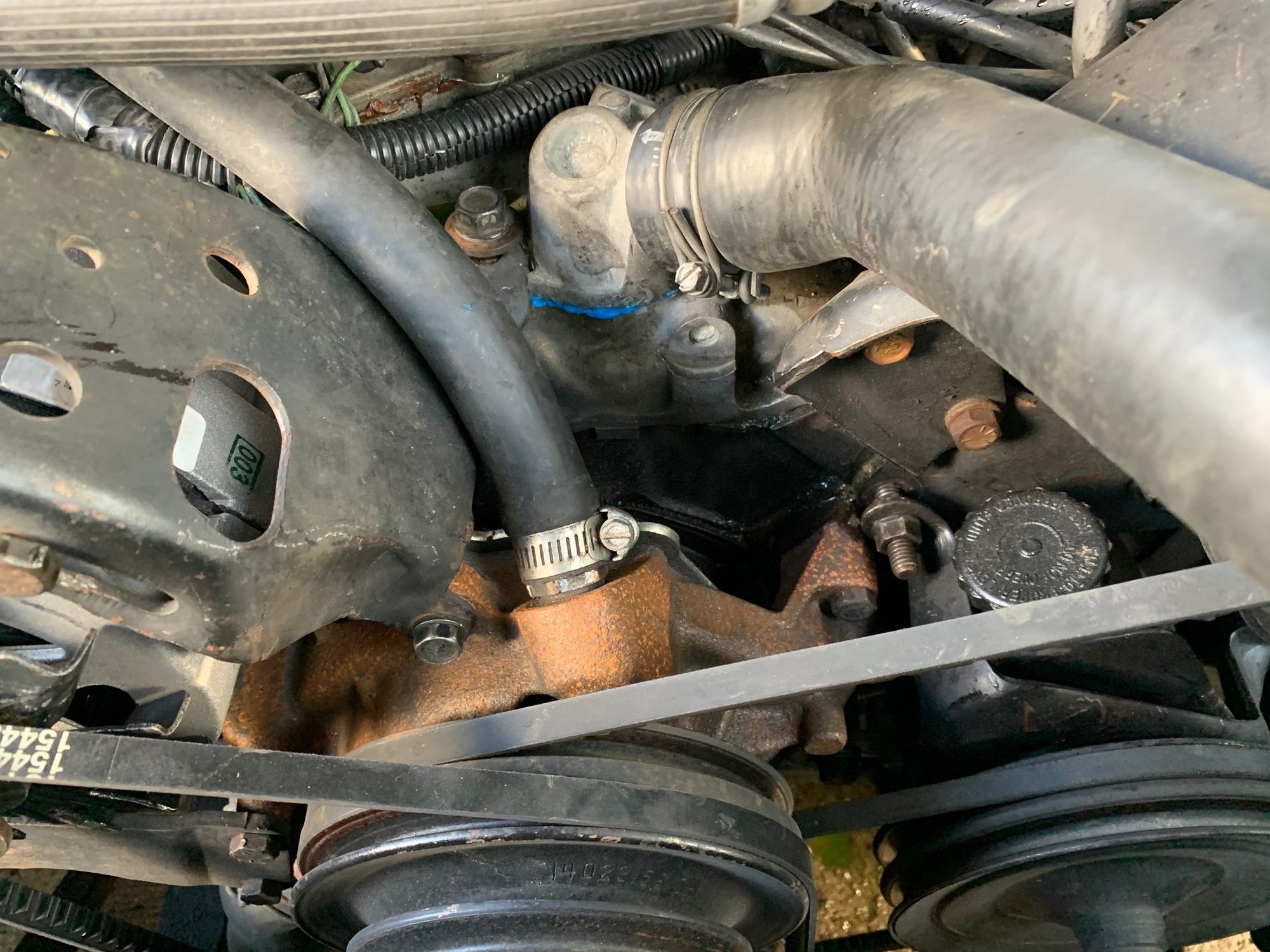

Also the thermostat housing has been stripped...was going to try to Re-tap it?
Thermostat housing stripped one bolt

get a 1 piece all rubber pan gasket-far better than the 4 piece with cork side pieces... A couple ways to fix the stripped thermostat housing bolt hole: do a "Helicoil " repair back to 3/8 16 thread or retap the hole to slightly larger metric size-M10 IIRC. may have to use socket head metric bolt.
