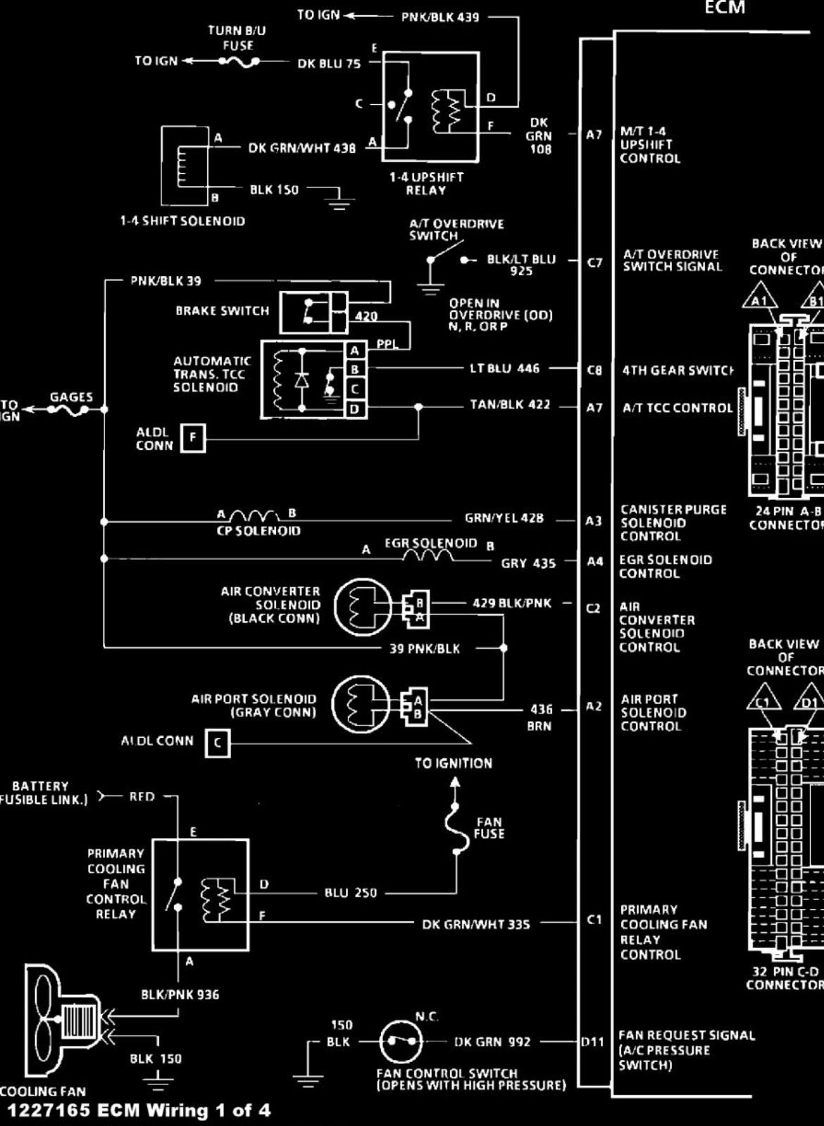

try grounding d11 at ecm here’s a schematic of the fan

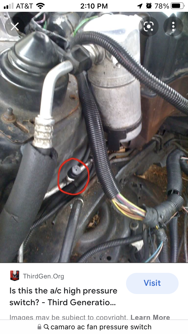

Can you post a pic of the ac pressure sensor?

iirc this is it, but like I said can just check if open or grounded at ecm d11.

Its on post #10 on Tuned Performances link...might be called ac fan pressure switch...I can;t recall.....
It's a little buried under the hoses / harness on the passenger side... its on the hard line that goes from the evaporator to the condenser. ... theres a I think black and blue wired connector that goes to it. On the 82 - 87 cars its right along the frame rail.. on the newer cars its raised a bit because of the evaporator design...
If its dis connected or the sensor is missing cause ac was taken out or something.... the fan should constantly run

I just got these offf the internet
