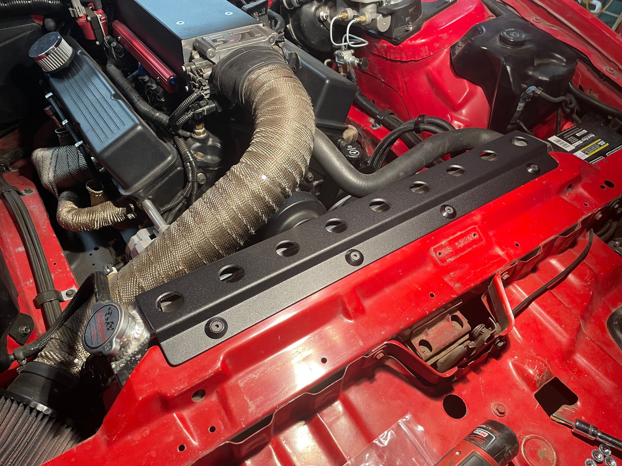

The Champion 2 core radiator is probably the closet you'll get to a larger direct replacement radiator, to get the factory upper support to work I ended up removing all of the factory rubber isolators and replaced them with adhesive backed weather stripping. when I made my aluminum upper radiator support, I didn't have to change the weather stripping I was using as rubber isolators.
That looks really good...
Thank you, quite happy with how it turned out.
