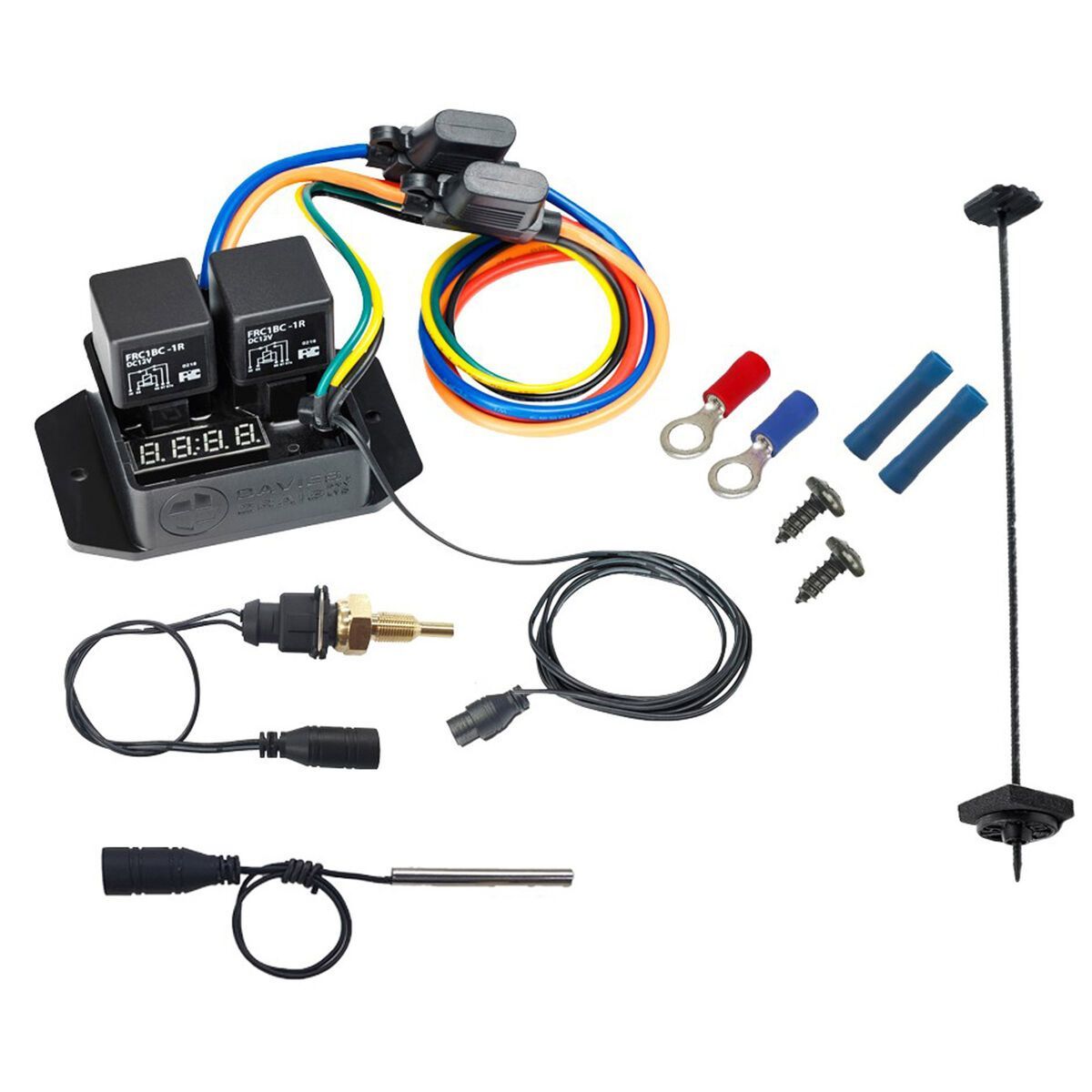

88 IROC TPI. First it was fuses blowing, now I can get one of the fans running in diagnostic mode/ jumping A & B of the ADL. But it doesnt run when I actually need it to. I'm not sure what is going on but tempted to sidestep all this and run with one of these. Anyone else done something similar

I got tired of fighting with the original system on my 1987 and installed a Dakota Digital fan controller using factory fans and new plugs to fans. Works great and programmable. I did need to relocate the Dakota temp sensor from the head to the water neck area. Didn't survive too long so close to the exhaust manifolds.
