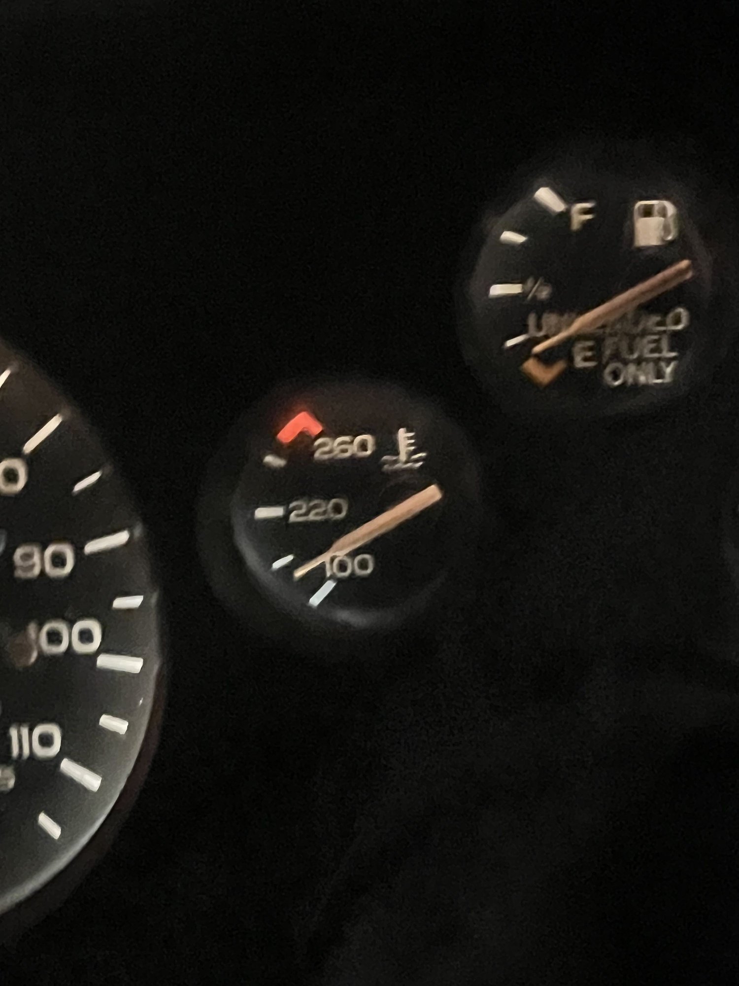

when I redid the tranny cooler and lines to flow correctly (they were backwards) and put a much better cooler in, it made a big difference as tranny temps are waaay better than before. This is where my water temp gauge sits at now, it used to sit above the first peg. So whatever I did made a huge difference, if I have the AC on it stays on the first peg and doesn't move, when I turn it off it goes back under the peg, I'm happy with these results so far. I'll test it more as it gets hotter out but now the tranny is one less variable. Even if it was getting to 220 with AC on it's normal for these cars, I just want it to cool itself off at idle when I turn the AC off which it seems to be doing now. If it continues to have issues ill look at the airflow at idle
