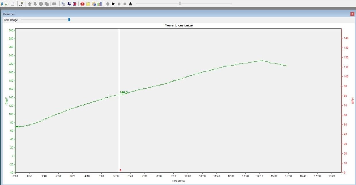

On the first slide, it shows a stock LB9 with 195* thermo from cold start to operating temperature. Red is speed, Green is CT. Notice the dip on the green line around 203*? That's when the thermostat opens. It will dip then start fluctuating once fan kicks on and off. In this case, the fan had been tuned to on 203* / off 204* but later retuned to on 200* / off 201* which worked better. I also swapped a mechanical fan switch, GM# 3053190, on 209* / off 199*. The combo worked perfectly and kepth the CT very stable compared to GM's original tuning.

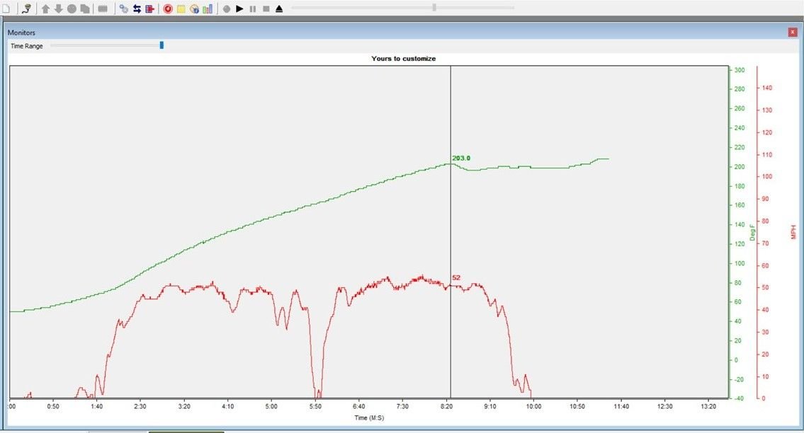

This second slide shows a defective thermostat on a stock LB9 with stock tune. It was an idle warm-up test in garage. One can observed the green line flattening around 146*, which indicated an early thermostat opening. However, there was no effect on cooling. The green line starts going down at around 228* after the first fan kicked in.

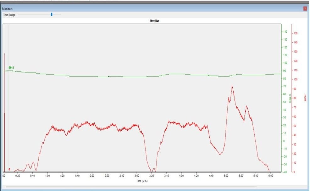

This last slide shows a 383 stroker TPI with LB9 stock radiator, dual fan and 180* thermo. Both fans are controlled by '7730 ECM. First fan on 187* / off 186*, Second fan on 190* / off 186*. Engine temp is very stable. Red is speed, green is CT in Celsius. As one can see there is a peak at 195* (90.5*) when car is stationary. It's the delay for both fan to start their cooling effect at idle. CT varied from 181* to 186* once we started rolling. Ambiant air temperature was 63*.
This following post shows the cooling effect of highway speed on a stock LB9 with defective thermostat opening at 150*. That should give you an idea of what a 160* would do without retuning the fans. It did go up eventually because the fans were set at 225*+. So a thermostat alone is not enough, you need to retune fans. https://www.thirdgen.org/forums/diy-...ml#post6511314

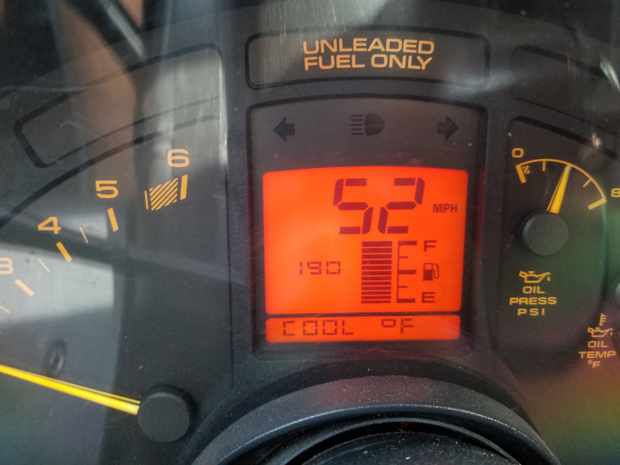

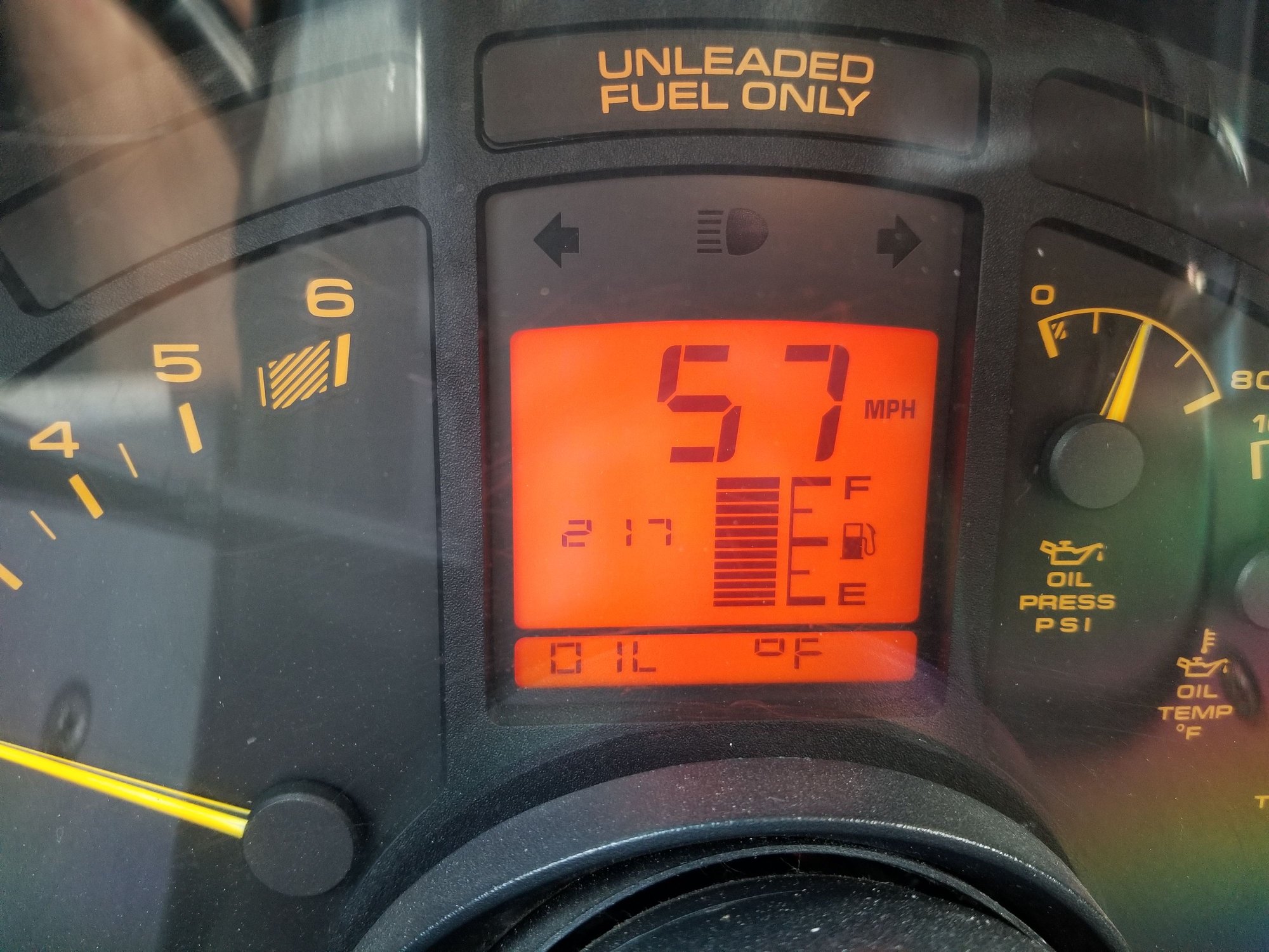

I haven't run a car with a 160 stat...that also had an oil temp gauge. I DID have an F-bod that I ran a 160 stat in (and NO stat, for a while) and I sold that car w/200k on it, still ran like new -to speak to longevity.
My current car (a '92 'Vette) and my previous car ('06 'Vette) both have oil temp gauges, both eventually get to higher oil temps than water temps. The oil takes longer to heat up, but given time and a load, it gets hotter than water. The 06 had an (stock) oil cooler so wouldn't get more than 10-15 degrees higher than water temps in typical highway driving....the '92 does not have an oil cooler and oil can get as high as 220 hwy, while coolant is at ~190-195 or so. Variations on that depend on conditions. At the road track, both cars would drive oil temps up to ~270-280 or so, in minutes and temps don't climb any higher than that. At the same time, coolant would be 200? 205? Ish?
This^ would be Max effort driving on 90+ degree days. One track day was 105 and numbers were about the same.
I would confidently predict that if I had a 160 stat in my current car and did the same driving routine, I'd see ~170-180 coolant temps combined with oil temps seen above, in similar conditions.

While we are talking about track and temps
Here's log from a road circuit track I did with a 2018 Camaro SS M6 1LE. It has engine, transmission and rear end coolers. It's the LT1 not LS. No clue what the thermostat specs are has it is probably ECM controlled anyway. That was early summer so around 70* ambient air. During hot summer sessions I get some CT highs in 230s but engine oil is always the same, around 250* max. It's a short track with lots of corner so we only reach 116-118 mph on back stretch. The fun part was the front tires at 265* temperature coming off a 30 minute chase style session with a Mustang Shelby GT350R... He had to box before me, his tires were just shredding lol.
Note: It's a wet sum system. We do run Mobil1 0W40 Supercar with extra quart for track session. We could also run 0W50. Car reaches 1.4G in certain corners. Just to keep in mind if you ever take it to road circuit, running thicker oil and adding some oil helps, but there is also the dry sump system options.
Just got back from a Salt Lake City; a 30 minute drive at 80 mph....

Man, the Corvettes are spoiled with the built in oil temp sensors. What thermo are you running, 180?

Yep. 180 is stock for the LT1.
Yep, the stock gauge is nice. Corvettes are my first car with that feature and it's been interesting seeing and playing with the conditions to affect oil temps. Based on those observations, I'd like to (someday) build an oil cooling system with a water-to-oil exchanger (like the one on the L98 between the filter and block), but rather than sharing that heated water with the cooling loop, I'd run that water through it's own radiator. That would require an electric circulating pump, and that is what makes this whole idea totally wicked; The electric pump could/would be controlled by an oil temp switch. You'd essentially have thermostatically controlled oil temp, w/o the complex plumbing required to port pressurized oil to various places to manage the temps. The thing electric water pump would likely never run in the winter....in the summer you could feasibly hold the oil temps down to whatever. Whatever you want to, I'd think.
