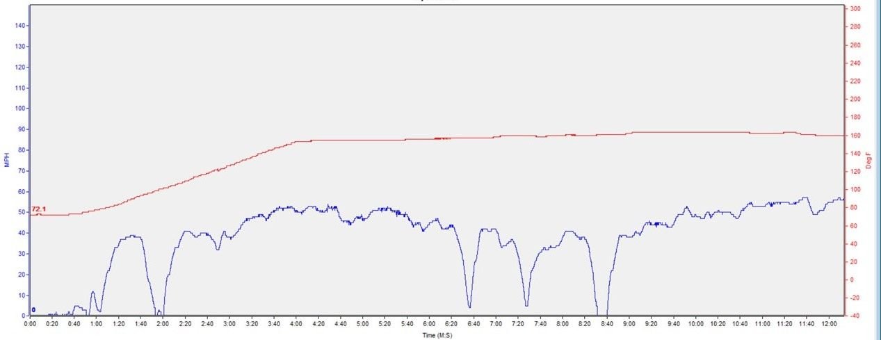

IROC-Z 1989, LB9 TPI, 5speed, low milage, bone stock, Upon data logging, I noticed a consistent pattern for CT. Temperature would increase at a steady rate and suddenly flatten around 150°F and slowly increasing to operating temperature thereafter. The faster the car was moving the longer it would take to warm-up, specially in cold weather where large CT swings were observed. At idle, the pattern was less visible. All pointed to a thermostat opening too soon or a faulty ECM CT sensor.

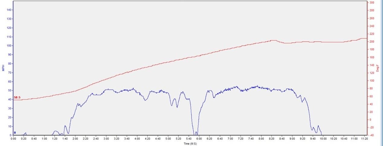

I ordered an OEM thermostat and installed it. Problem solved!!!!!

DEFECTIVE 195°F
NORMAL 195°F
