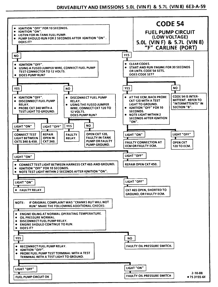

Check this chart out.

page 2
Old May 10, 2004 | 12:46 AM
1993GMCPU's Avatar
Joined: Jan 2004
Posts: 112
From: OK
Car: TBI CHEVY, TPI 5.0 HO
Engine: 5.7 FIRST hp SMALL BLOCK, BIG BLOCKS!
:hail: Thank you
I appreciate the insite and if this works, the beast should be running tomorrow as new one must of been faulty!
