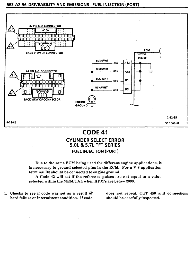

If you have a code 41 and your car is a TPI. It means "CYLINDER SELECT ERROR" and deals with the engine grounds to the ECM. The things to check are the ECM connections and the ground to the engine. Maybe this will help.

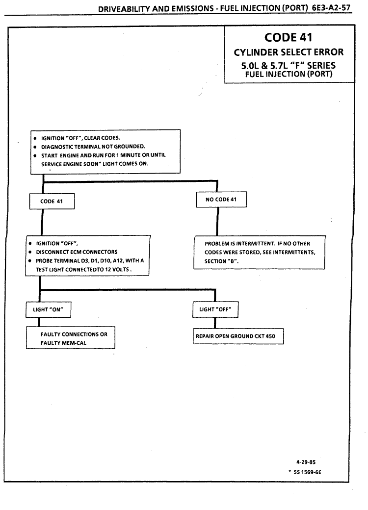

Page 2

i did what that thing said and didnt get a light on any of the terminals so that means i got a bad ground somewhere then?

That would be a safe bet. check the grounds at the back of the cylinder heads. That is where they connect, if the connection is good then one or more of the wires is broken.
