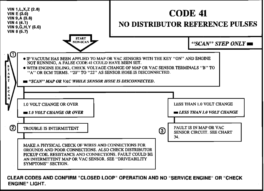

Has anyone ever fixed a fault code 41, stock ECM. The fault is no distributor referance pulse.

Edited: code 41 will be no distributor reference pulse on the CCC vehicles. See attached jpg.
In the future please include more information about your vehicle.
