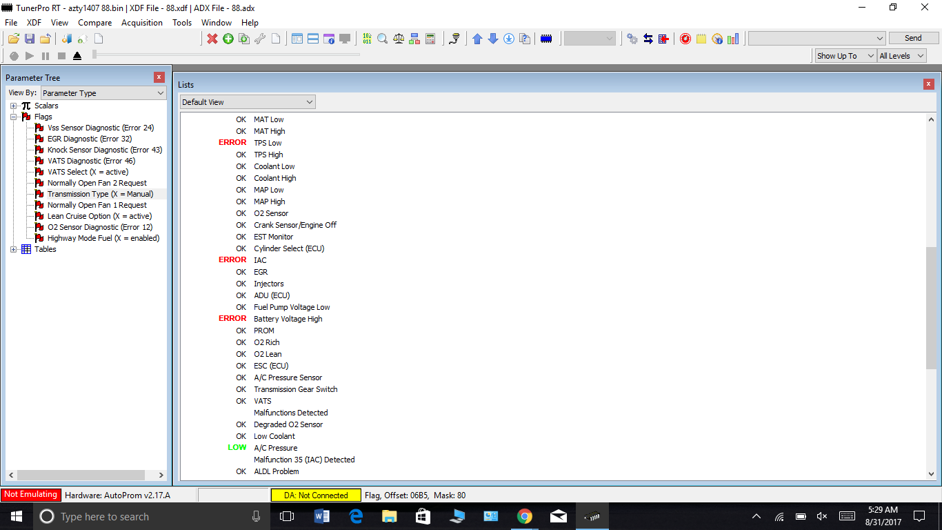

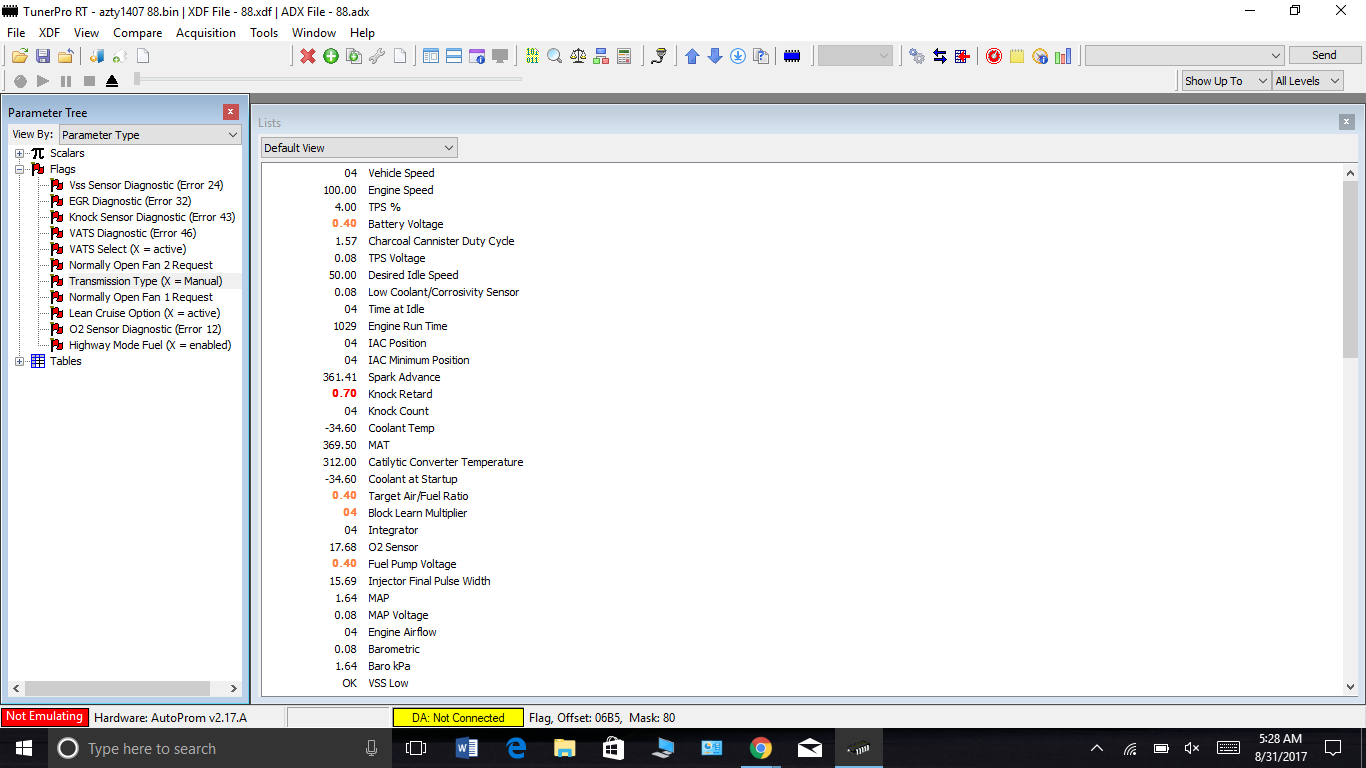

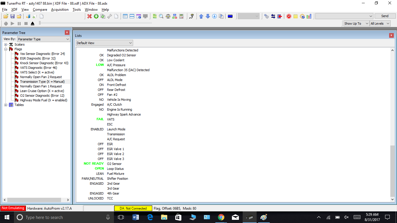

One more question(for today at least). I swapped that pin around and got the computer to successfully connect, however it will only show a snapshot with nothing changing. I also have no History tables available. Is this an issue with the swap or the computer?
I am using the "azty1407 88" bin and the $88 xdf and $88 ads.
The values it is seeing are all way off too. Like the -34.75(ish) C coolant temp and the spark advance is being read as something like 1300.

this is what I get every time I connect with tunerpro. I get this both with teh apu1 autoprom and my aldl cord.
The data could be a chatter packet. Which is also much shorter then a data packet.
