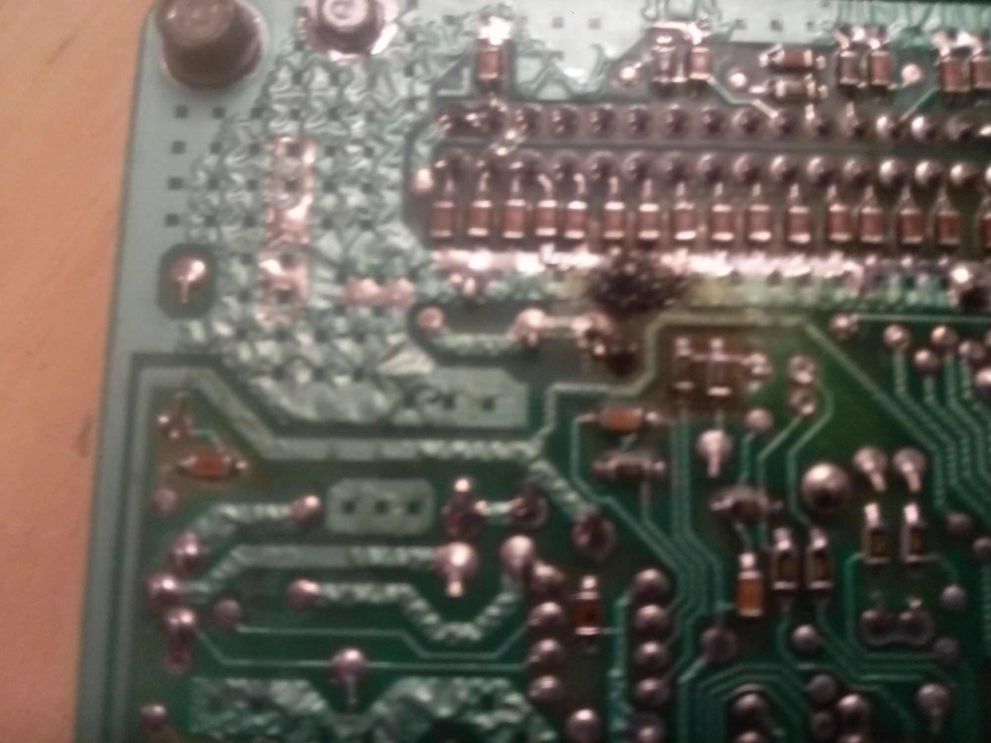

Can you post a detailed picture of the inside of the ECM?

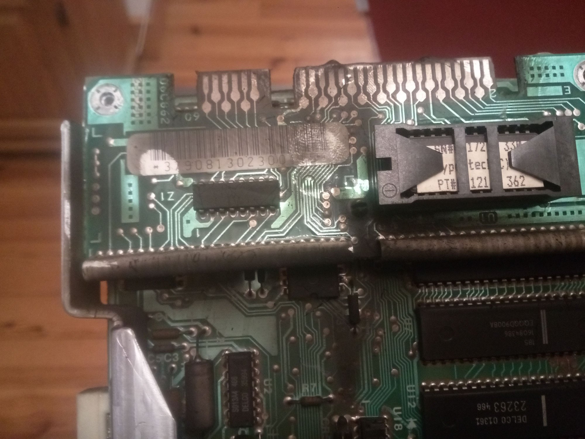

Thanks for your reply, I was checking the connector with the yellow and black wires, the sensor reads 7500 Ohms and the connector reads 12V across the 2 wires with the ignition on. I've also attached some pics of the ECM.
Paul

Yes, that ECM took a voltage hit. The device that fried is for transient voltages. I've seen where that device has failed, but not to that extent. And since there is battery voltage running though the ECM (instead of +5 volts). I'd say the ECM is fried. It may be repairable, I've worked with some with good results. But back to the question.
A jolt of voltage can be caused by various means. Using two batteries in series for a jump start. A bad alternator (can get it tested), or loose/bad alternator/battery cables. An alternator that loses sense can output 70 - 80 volts.
Other then this I'm not sure what to tell you. Maybe someone else has some input.
