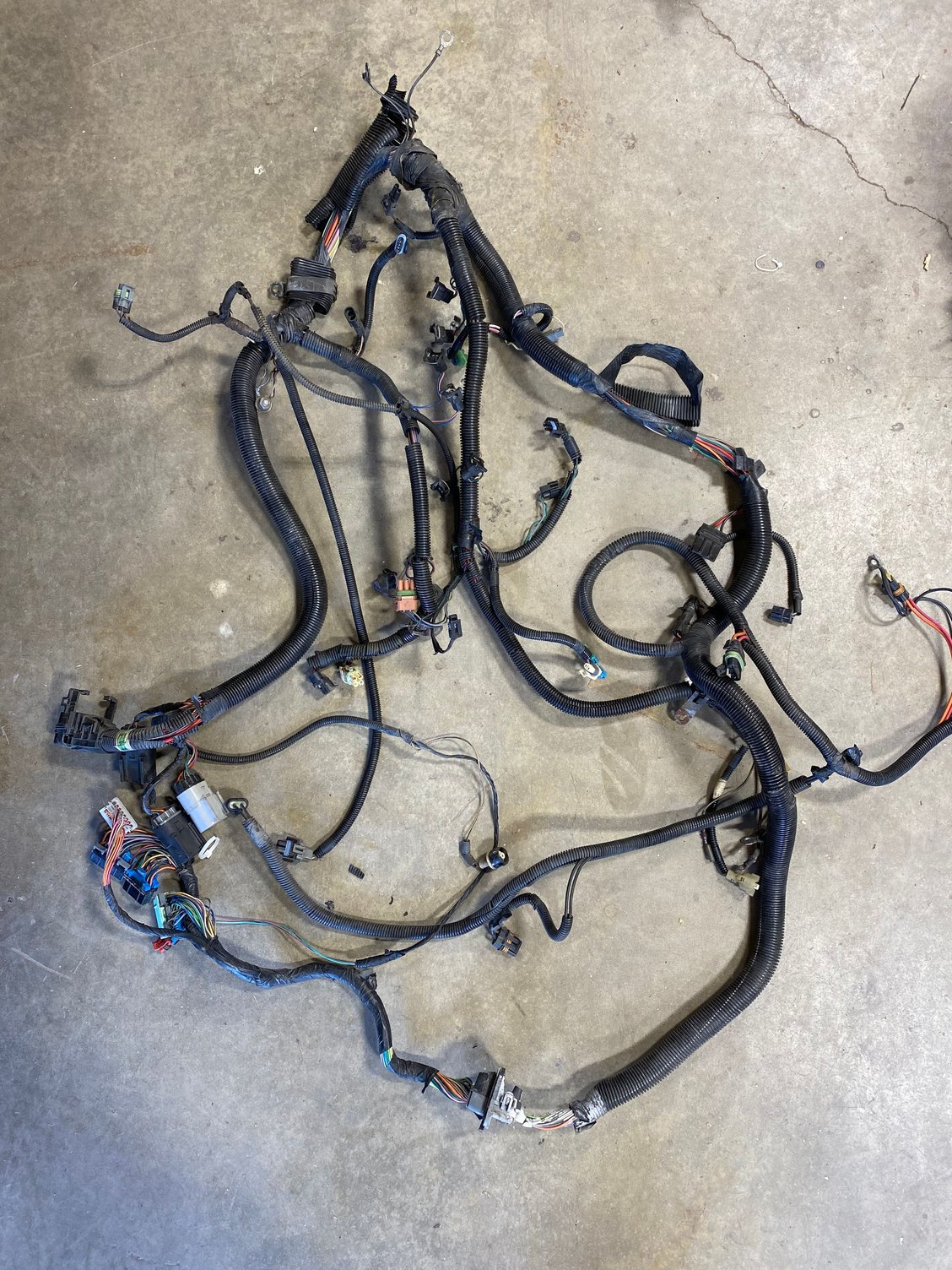

I removed the stock harness from my 91' Z28 and I'm in the process of installing/wiring a Holley Sniper EFI. I have a complete harness that I'm feeling a little hesitant about chopping up as I believe they are hard to come by.
If I did sell the main harness, what do I need to look for when buying a harness to put back in the car? I would like all my stock gauges and accessories to work (no heat or AC).
Thanks!

you are essentially going to need to interface to the C100 connector (the connector on the engine firewall driver's side) in the engine compartment and then also the C207 connector in the passenger side dash area where the original ECM was.
Search and look up the pin outs for these connectors and you can see the functions of each pin and also determine which ones you would like to have function for your set-up... for example the coolant temp gauge and oil pressure gauge
you can buy these connectors, however getting all the connectors, pins, crimping tools, etc is likely going to be more $ than you may want to spend if this is the only swap you are doing

I've got a 91 Z28 and when I did my Holley HP unit in 2014 I just ripped out the ECM and all related engine wiring then cut and spliced into everything I needed to get it to run perfectly
