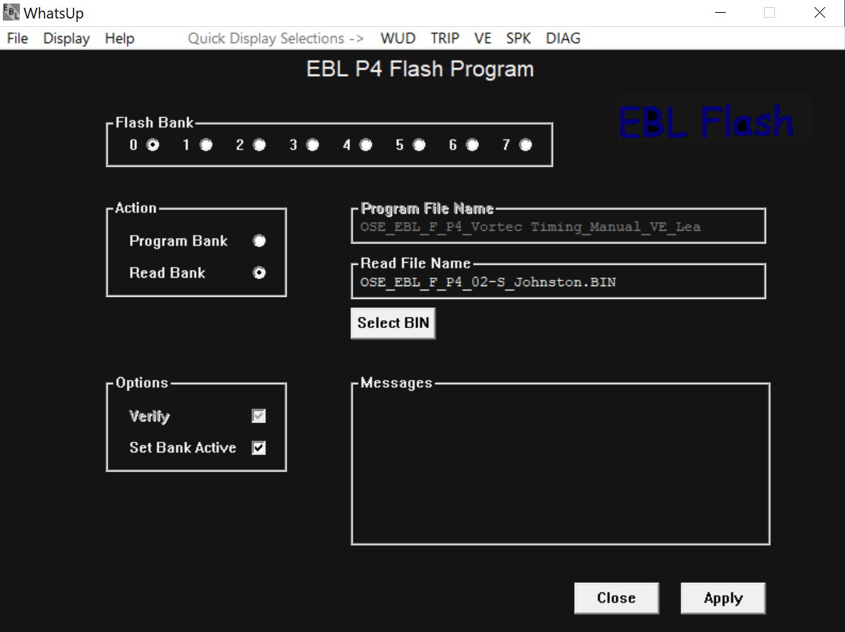

Should the read file be the same as the Program File once you flashed a new bin? The current Read File is the original file that I flashed when I started and I have flashed several since. Shouldn't it update as I load new files?

The program file name is the name of the BIN to be flashed into the ECM.
The read file name is the name of the BIN and location on the laptop of where a BIN from the ECM is placed.
If you want to flash in a BIN, change to the action to program bank.
