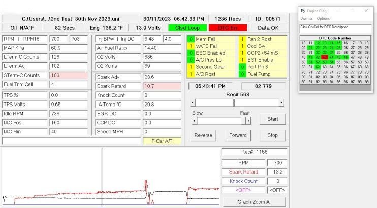

DTC 43 .No knock counts. WTF
Chasing long time problem.
ZZ4 / HSR / 730 / 8D / aftermarket harness has been running perfectly for 12+ years.
6 months ago started running rough when stopped at lights and sys light came on.
Shows DTC 43
Following 3rd Gen recommendations EVERYTHING , in the system has been replaced with new or known good including a different ECM and a different tune.
All wiring segregated.
Unable to fix problem ,currently have the resistor on the KS circuit.( resistor can be seen from ECM plug - to conform wiring good.)
As soon as engine starts ,it puts up the code , but there are no KC showing ?
As soon as engine starts , it retards spark as shown but when revs raised @1500 rpm ,spark retard goes to zero until it returns back to idle.
Engine is closed loop , stable 700-750 rpm idle
Any thoughts ?

Re: DTC 43 .No knock counts. WTF
Thanks
Been through the 43 flow chart so many times know it off by heart.
Everything is as should be ( test wise ) but problem persists.
On 90-92 '730 MAF ECM , IIRC , the ESC is not on the memcal anymore ?
Has custom tune on a 27SF512 chip using ZIP Moates adapter .
Replacing with a previously know good tune on a different chip had no effect

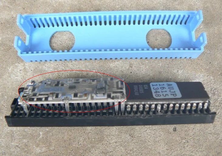

Previous years MAF TPI used a Electronic Spark Control Module in conjunction with a 100k ohm KS. Circled in red...this is the knock filter that is still being used even if you're using a Moates G1 adapter. I've never had a knock filter go bad before but were you able to swap that out since you said everything in the logic tree checked out? I don't think the bin has anything to do with the code 43 as I've mentioned it's a circuitry issue.

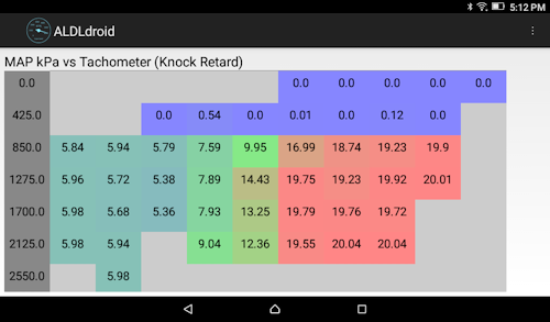

As you described, mine didn't do what yours is doing...not the best chart but it shows spark retard above a certain rpm at all kpas and increased with rpm.
...and this is after the botched wiring was fixed.
