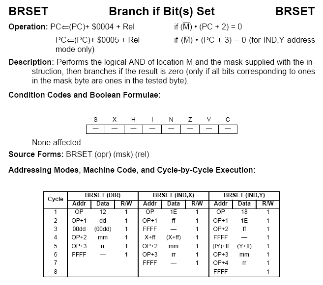

I dug up some old data and viewed it in Datamaster ... which allows you to look at the status bits. I can watch each status bit of the AIRMW. Assuming you are counting bits as 0 through 7 (and not 1 through 8) ... it is bits #1 and #2 that represent the 2 solenoids for AIR management.
According to the anht_hac AND according to Datamaster ...
Bit #1 is Air Dvtd
Bit #2 is Air Port
Most of the time, bit #1 is active (de-energized) except for WOT and Deceleration. I find it hard to believe that GM would be diverting air to the cat that much ... it has to be going to the manifolds. Furthermore, it is when bit #2 is set that Air is going to the cats ...
... and this DOES happen on startup according to my datamaster logs. Given that the code actually checks for bit #2 ...
Tim
Bit #1 is Air Dvtd
Bit #2 is Air Port

EDIT - I'm changing some thoughts. Let's look at the code again ...
Code:
LDAA $8496 ; 0.60 V FAST o2 R/L THRES AT IDLE LC9C9: BRSET L003F,#2,LC9D0 ; BR IF AIR CONTROLED, 0 = DIVERT SUBA $849D ; 0.10 V DIFF R/L WHEN AIR DIVERTED
Tim

Originally posted by 91L98Z28
from a 68hc11 manual
Example:
I know that this means Branch to LC9D0 if something (#2) is set at location L003F.
Does this ultimately mean that a branch occurs if L003F is ...
0000 0100
OR...
0000 0000
I am thinking it is 0000 0100? If this is true then Scot is right and GM did make a mistake.
Tim

Trax, in the instruction BRSET L003F,#2,LC9D0, the #2 is a bit mask, not the bit number. It is: 0000 0010, being a decimal 2 in binary, is bit 1. The '#' before the 2 defines it as an immediate value.
So the instruction will BRA to LC9D0 when bit 1 is set in RAM location L003F: xxxx xx1x, the x's being 'do not care'.

rbob, took the words out of my mouth.
a quick/easy way to see this is to look at LCA67 (page 169 of PDF HAC):
LCA67: BRSET L003F,#$80,LCA79 ; BR IF b7, DECEL ENLEAN ACTIVE
'course, there is no 80th bit, the mask is actually:
1xxx xxxx
also, I did notice a bit of an inconsistancy in the hac which might be confusing:
LCAC6: BRSET L003F,#2,LCACD ; BR IF AIR NOT DIVERTED, 0 = DIVERT
notice that the mask is specified differently, even though the meaning is the same. the full BIN instruction for each is:
12 3F 80 0E
12 3F 02 03
(opcode, operand, mask, relative offset (where to branch to))
same opcode, same way of specifying the mask. Probably just a typo in the HAC but it confused me until I looked at a .BIN to see it was the same thing (i thought there might have been different ways to specify the mask, such as directly by bit (#2) or a regular mask (#$02) but I wanted to be sure before I posted.) I thought maybe trax was picking up the bit mask differently because of the #2 instead of #$2.
1xxx xxxx
12 3F 80 0E
12 3F 02 03
