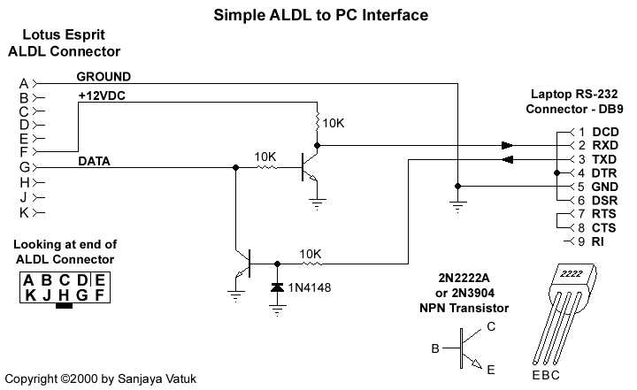

Hey, I've soldered everything to the bread board except I'm not sure where to attach the ground part of the two transistors. Do I ground them to the ground part of the DB9 cord or to the A socket in the ALDL?

both...the ground from the ALDL goes to the ground of theDB9 socket.

What about the emitter part of the transistors? They go the same ground I guess?
