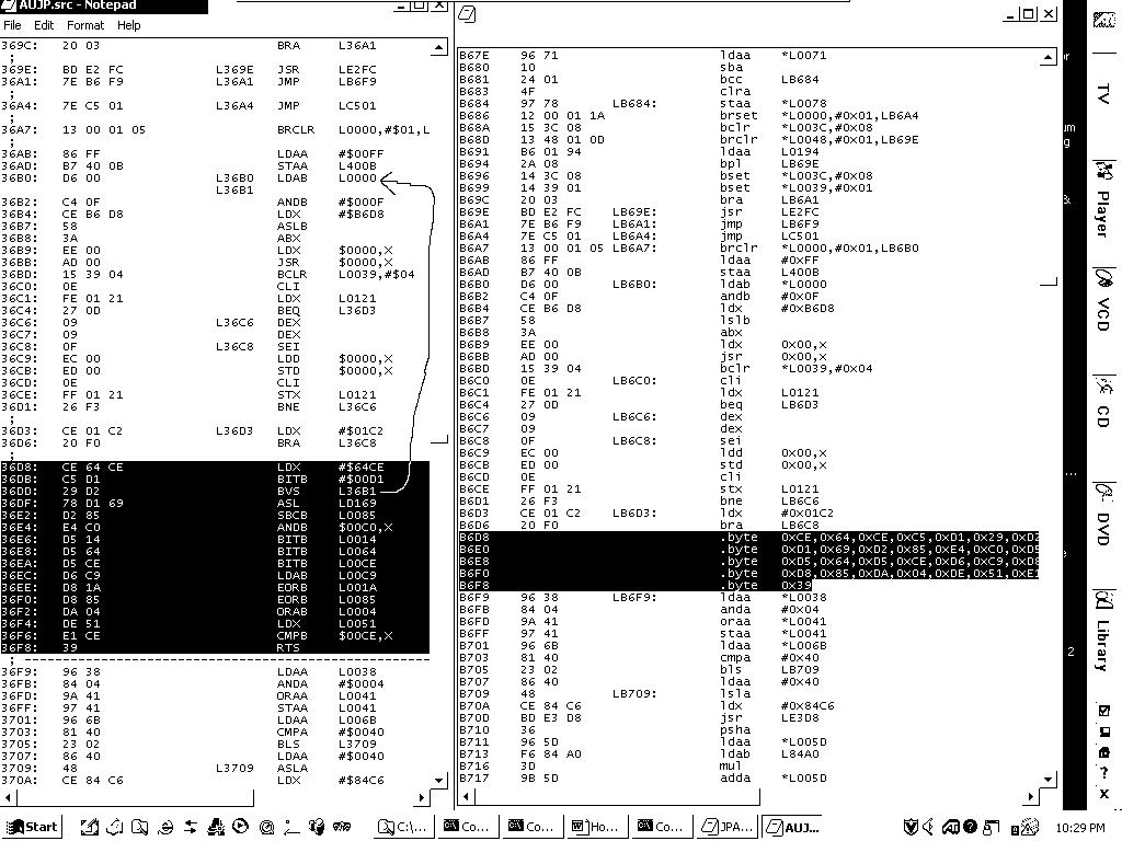

Ok After going through a Hack This is the code I find
Code:
				;>>> Cooling Fan Tables & Params <<<
LC309:	.db	0x23		;Minimum MPH for using Fan 1 Duty Cycle
LC30A:	.db	0x0B		;MPH for Fan 1 Turn on if A/C ON

I've run across a section that is giving me trouble (might just be the way I'm counting in hex)
The code looks like this
LB1E2: ldaa #0xFF
LB1E4: staa L011D
ldx #0xFF00
stx L400B
ldaa L4008
ldaa L4005
adda #0x02
staa L4006
ldaa L4009
ldx #0x4000
bset 0x07,x,#0x27
jmp LB6C0
.byte ,0x01,0x00,0x2A,0x03,0x7E,0xED,0x2B
.byte 0xCE,0x40,0x07,0x1E,0x01,0x01,0x3A,0x1F
.byte 0x00,0x20,0x08,0x1F,0x01,0x20,0x31,0xBD
.byte 0xEA,0x25,0x3B,0x1F,0x00,0x80,0x08,0x1F
... You get the jist of it.
From what I'm counting, the "entry" should be B1FC
That is not working.
Am I not considering a double address or something here?
Old Aug 25, 2004 | 08:53 PM
  #79
JP86SS's Avatar
Joined: Apr 2004
Posts: 3,180
From: Browns Town
Car: 86 Monte SS (730,$8D,G3,AP,4K,S_V4)
Engine: 406 Hyd Roller 236/242
Transmission: 700R4 HomeBrew, 2.4K stall
Axle/Gears: 3:73 Posi, 7.5 Soon to break
FOUND IT
OK, in case you didn't catch it the way I didn't.
The #0xFF00 and similar entries are counting as two bytes.
Pretty sure anyway.
Using that mentality I'm getting through much more now.
Not sure if this is due to the addresing or just the actual command using double bytes.
If someone could clarify that, that would keep me moving in the rightdirection.
TIA.

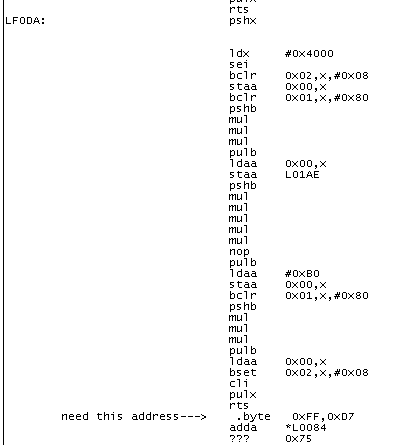

Clarify Pleeeease !
I'm loosing my mind on counting this address.
Take a look, I'm coming up with "F112".
I know thats not right but if someone could look at this pic and give me come clarification on if I must figure in each "fuction" and figure out if they are single or double byte to come up with the ending address.
I don't want the answer!
Just some insight.

The 0xFF00 is a 16 bit, or double byte value. The value in decimal will be 255 * 256 which is equal to 65 thousand something. Itll be 0xFF and then 0x00 when the code is converted to a 'bin'. Is this what you wanted to know?
Old Aug 25, 2004 | 10:06 PM
  #82
JP86SS's Avatar
Joined: Apr 2004
Posts: 3,180
From: Browns Town
Thanks Dimented24x7, but what I'm tring to do is come up with the actual value (address location) for that " .byte..." section.
It needs to be defined in the control file for the bin to disassemble correctly.
I'm just not counting the address locations Vs. the instructions in the list (not correctly anyway).
edit:
The rts is not part of it (at the top) and the blank spaces are just Crefs.

Ok, I guess you want to get an offset from the known location to determine the address of 'byte ...'
In machine code, each of the pneumonics themselves should be one byte. Each of the double byte values following the pneumonic will be two bytes. All of the single bytes after the pneumonics will be one byte apeice. (come to think of it im not entirely sure either, never bothered to manually calculate addresses)
An easier way to do it would be just to assign it as well as the commands that use it a label and let the assembler calculate the actual address. I find it too hard to calculate addresses.
re-EDIT: NVM
Old Aug 25, 2004 | 10:30 PM
  #84
JP86SS's Avatar
Joined: Apr 2004
Posts: 3,180
From: Browns Town
I agree, it is a PITA !
but to get my file to properly Dis-assemble, I needto do it to remove missing parts of code that are being interpeted as data.
Problem as I see it is reconizing which of the pneumonics ARE the double byte values
Then I can count correctly and put the "entry" location in the control file.
BTW, I'm playing with more of the disassembler settings to see if I can't get it to output ALL adresses. (that would be cool)

1.) Is there any code between the "load" address and the b000 address ? (load 8000 and B000in my case)
2.) I have one part of code that I cannot get the lump out of.
It has a BVS (Branch if set) that is to goto B631, B631 goes to L0000.
The assembler states that this has two errors, u and a.
(a) Indicates a machine specific addressing or addressing mode error.
(u) Undefined symbol encountered during assembly.
Can this be an instruction that this particular assembler does not understand?
If I DO NOT un-lump this, it assembles and compare exactly.
If I put in the "entry to remove the ".byte.." it changes to code that I can follow but will not assemble because of the error.
(only 1 there is)
This is AUJP, in case you wondered.
I feel I'm getting real close but am over doing it somewhat.
I have only a few more questions on if it's needed to really add all of the vector interrupt returns, but that's later.
TIA

Picture of the culprit, if it helps.
File Type: bmp
Old Sep 8, 2004 | 06:18 AM
  #98
RBob's Avatar
Posts: 18,432
Likes: 234
From: Chasing Electrons
Car: check
Engine: check
Transmission: check
Your 'lump' is a lookup table. There are sixteen addresses consisting of 2 bytes each. The first address is $CE64, the next is $CEC5, the next $D129. . .
RBob.

So that really is not code, but actual data.
No wonder it worked with it left alone.
Thanks for the help on that one.Now I'm going to begin the commenting of it and learn what is happening.
