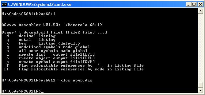

Hi Guy’s,
I think that everything that you are explaining will be for my next level.
Reading other posts I thought that the instruction was clear.
1- First make a disassembling from the BIN file.
2- Make a reassembling so that you make the same BIN file.
3 - Compare both files. (It should be equal)
Later – Interact in the code, making patch files, change of remove things.
So here is the deal:
1 - I use the Dewtronics Disassembler “M6811DIS” to make a disassembling. (I get a “DIS” file)
(This disassembler targets is the AS6811 assembler written by Alan Baldwin)
2 - I make a reassembling using the “AS6811 assembler written by Alan Baldwin at Kent State
University’s”
3 – I get with out errors the next files; “APYP.LST” “APYP.REL” and “APYP.SYM”
There is a “ASLINK.exe” but I don’t know how to use. (relocating linker)
Here start my problem, “How can I get a BIN file from here?”
Regards,
Cobra289

Hi MTPFI-MAF,
Assuming that you are at the correct directory and you put the APYP.DIS at the same directory.
You need to type the next:
As6811 –xlos apyp.dis
Check the screen shot that I made.
There are more switches as you see but I don’t think that are needed at this moment.
As you see there are no errors.
I hope that RBob can help us converting those 3 file to a BIN so that we can compare.

After unzip you get the directory “AS6811N” here you put you disassembled file. (In our case APYP.DIS)
The software will make 3 files at the same directory. “APYP.LST” “APYP.REL” and “APYP.SYM”
If there are no errors you can continue. (Errors will be displayed at the DOS box.)

Yep, it one thing to just be able to read the code, and another to actually modify it.
Taking care of large areas of 00's can be taken care of with this *note*.
Fill $00, $FFED-*
If you don't comment the 00's when it assembles the assemblier might just use whatever it sees laying around, ie notes that are commented out with ;'s.
I got some oddities I haven't figured out yet. In some locations I get a CE when it should be a FE. The .asm reads correctly but the assemblier in some areas uses the FE instead of what should be an FE. Dunno what's up with that yet.

Just an educated guess, not looking at the code, the difference between a CE and FE is the type of load. This is most likely a LDX or LDY instruction.
The CE is a load immediate. IE: load the value at the instruction.
The FE is an extended address. IE: load the value found at that address.
Look for a # that shouldn't be there. Or maybe an *, I think the as6811 assembler uses that for a particular addressing mode.
RBob.
P.S. you guys have it easy. I had to write my own disassembler to get this far. . .

You can also use the origin command to keep the vector table (or whatever else is there) in place rather then using fills.
ORG $[start addr of table in hex (or in decimal w/o the '$')]
Itll automatically pad the end of the actual code when assembled to ensure the vector table starts where it should.
